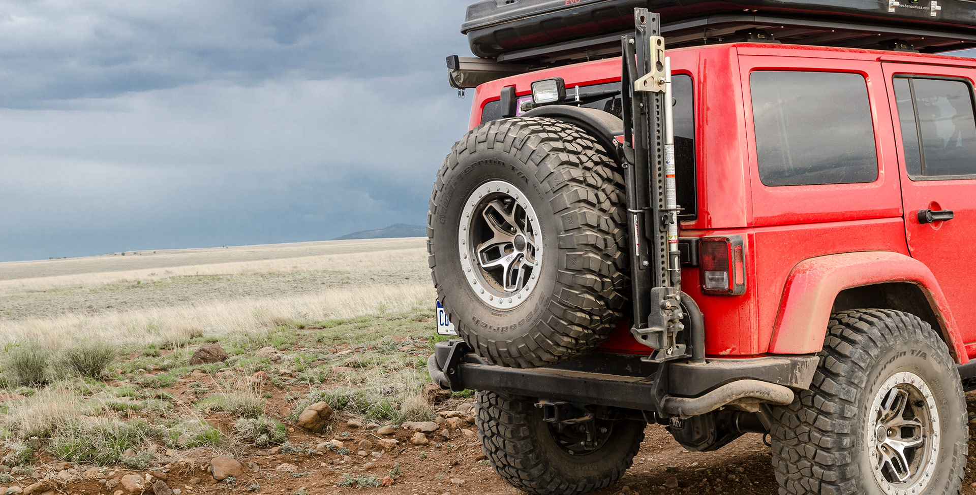

Hopefully at some point a brand will offer a swing out tire carrier that attaches to the bumper that will take the weight off the door, similar to AEVs bumper for the Wrangler. I’d imagine the steel bumpers would make a good host for that sort of thing.
I’ve not owned a Jeep in a while but in the ones I owned in the past, the rear hinges always start to go bad as the truck aged, larger tires were added, and/or off road use.…or hangin’ additional gear off the tire😂😜

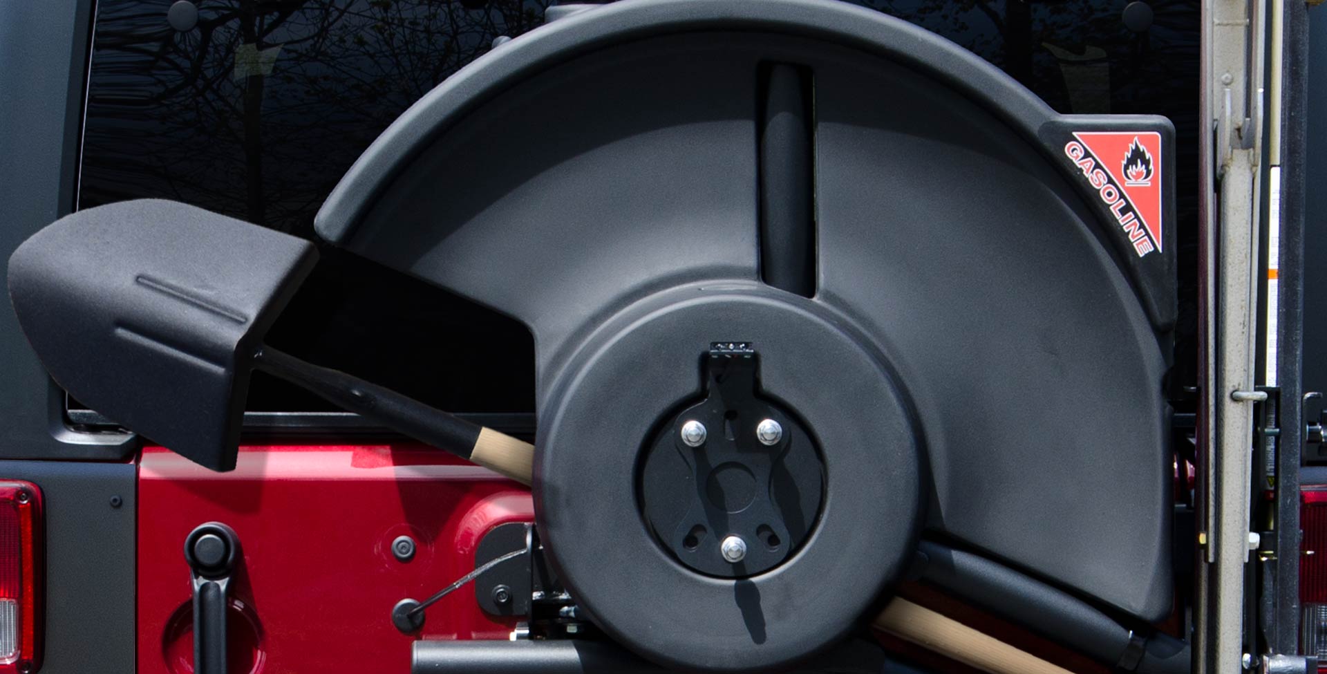

Poking around AEVs site some more, txhis is kind of an ingenious idea for off-trail fuel storage
