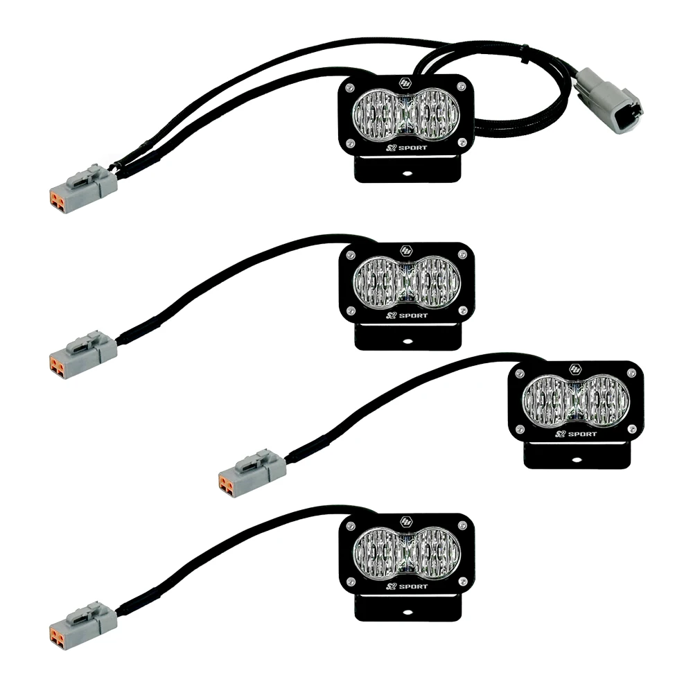

I powered my UHF of the front passenger foot well outlet and like @Shopkeep hooked up a stedi LED light to the LHS rear roof outlet.
Cheers
Steve
Lots of side mount ideas here:
Work light on roof grab bar
You can do that Stedi setup yourself by buying the parts direct from Stedi for about $150, plus a Deutsch plug kit.
Is that this one: https://www.stedi.com.au/micro-v2-7-8-inch-12-led-flood-light-amber.html ?
On that page it says "Environmentally sealed Deutsch DT02 with male and female included". Does that mean it's plug-and-play or do I still need a Deutsch plug kit? Also wondering where you got that bracket to suit the grab handle bar, or did it come with this light?
Stedi do 3 versions of the 7.8" LED light, Amber, white and a dual colour version (which has external switches). The lights are wired with a DT plug, whereas the Grenadier has a DTP roof outlet connector, These are different types of Deutsch connector so you will have to make an adaptor.
My dual colour LED came with a DT plug - bare end wire pig tail to which I crimped/soldered a DTP plug so I could plug into the roof outlet.
Cheers
Steve
Cheers
Steve
Ah gotcha, so they're not the same. Still learning 😅 I did see those dual colour ones, looks great and could be good for camping nights with dimable amber light!
Dual colour can also be switched on and off from the outside. Also the two outlets on the left of the car (at least in RHD vehicles) are activated from the same internal switch, the dual colour means you can switch it off and have something in the other outlet still on.

I've used the interior power points for an extra USB power outlet on the passenger side and footwell LED lighting in the front and rear seat area using the driver-side power point. I've added Morimoto 1Bangers on each side of the truck (flood) and two amber ones (wide beam) facing rearward as chase lights. I also wired in external switches to the lights so I can control them independently. I'm not a fan of lighting up a campsite more than I need to. I may even install a dimmer at some point for the lights on the sides as the 1Bangers are crazy bright for "scene lighting".
Yes that’s the one in my install, you can also get a dual colour touch version. The brackets are Stedi 22-30mm vice bull bar clamps. You will need different bolts to fit the lights as the supplied ones don’t fit through the clamps. Need to change the DTP plug to a DTP2, you can buy kits for this.
