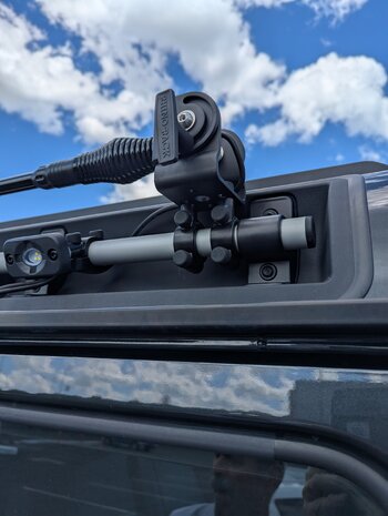

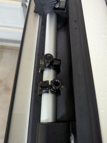

25mm motorcycle handlebar mirror mounts work well on the grab bars. They come with either 8mm or 10mm threaded holes. I posted about it over here. All you would need to attach those Stedi lights is to rotate them outwards and attach a pair of L brackets. Get them at a local bike shop, Amazon, EBay, etc.
I got the idea from this pic I took of another forum member's folding UHF mount.

Thanks sir, this looks like it would work perfectly. Appreciate it!
