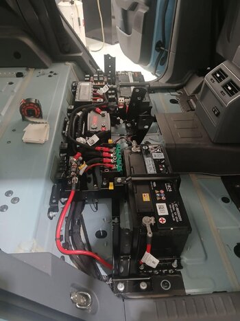

For anyone that has a station wagon that did not come equipped with a second battery and have since added one, what are you using for a tie down? Is the one pictured below a factory bracket? I see GP Factor has a clamp but it still says to use in addition with the bracket.
If it is factory, does anyone know a part number or where to source one?
Considering a 165ah battery that's 8.5" but its a tight fit under to stay level with the factory plastic trim covers. Agile is putting the 200ah Victron in and that is almost 9" high and fits but does not leave a lot of room for the system to breath. The redarc is an option but I haven't seen anything from a technical standpoint that warrants the $1000 delta over the battery I’m considering. It is only 7.5" tall so will likely tuck in nicer. All moot if i cant secure it down.

As a point of reference, these are the factory brackets. Closest is the auxiliary side. The bracket in that pic looks similar.

I bent my own. Lined it with 1/8" thick sheet rubber and put rubber under the battery as well. I went with the 120ah Epoch battery and it fit well. I ended up cutting away a lot of the plastic around to make everything easier. I've seen a lot of the build threads here that have done the same thing.

While I haven't done it myself, I suggest that a simple metal battery bracket and a few spacers would work for you.

I didnt have the factory second battery but fitted one myself. I bought the factory bracket. I could of made one but the factory bracket was £88 and I was short on time.
I saw this one at Genesis and asked if they sold it separately, it was $79 with shipping. I liked that it was height adjustable.
Sure I could have gotten one like Landmannnn found but if it isn't at least twice what it should cost, is it really a part for a Grenadier?
I'm using a group H9 Interstate AGM. Uses an H9 hold-down with factory bolt points. I can measure tomorrow- if I at some point want to move to the RedArc LiPo, it's a direct fit. LMK if you want measurements- I can hit up shop for exact part.
It does seem expensive, but I suppose if they are getting a short production run of 20 or so units then they would probably end up paying $25 per unit. Plus Grenadier tax that would be $80 or so retail.
