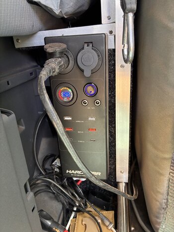

Several people have replaced the Smartpass and second battery with Redarc system and rewired to have consumers run from sexond battery and preserve starter battery. Thats how we would normally set things up here in Australia
That’s what I did after a few frustrating months with the dealership re power loss on batteries
It’s fixed the issues when bush and feel confident - most of the time!😵‍💫
The wiring to the rear compartment aux plug was a bit thin so beefed that up and put a Hardkorr power distribution pack on the back for easier access
