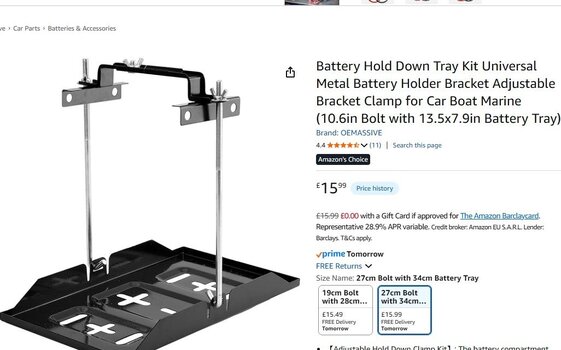

While I haven't done it myself, I suggest that a simple metal battery bracket and a few spacers would work for you.
