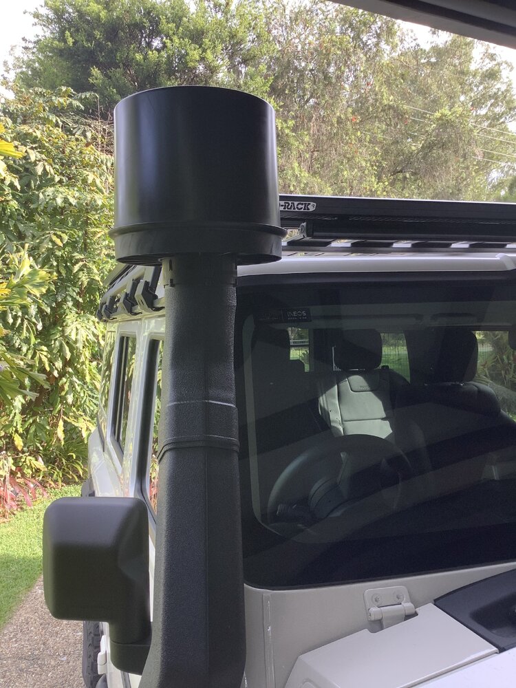

I've only seen one person post a photo of theirs when they got it with their vehicle:

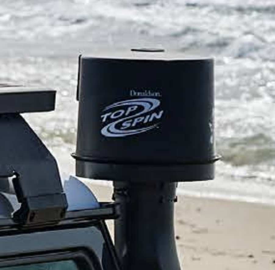

Hi Andrew. I have the Donaldson top spin fitted. These are the top of the range and self empty. You don’t get the normal snorkel end as well. I might see if it is available as well but don’t mind the garbage to in look of the pre cleaner.

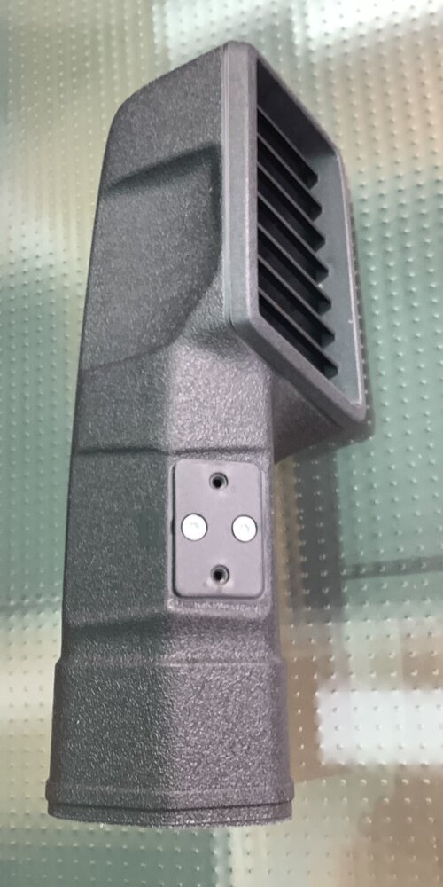

The pre cleaner is an accessory fitted by the dealer (as I understand it - can’t imagine them shipping it with that adding to external dimensions in any circumstances!).
My dealer (Ignition Car Centre) gave me the original air intake back in case I wanted to use it as well…. and any dealer should at least offer that, as it is something you have paid for.
Thanks will ask.

Good info, thank you! Do you know if it's a Donaldson top spin with an Ineos badge?

The Top Spin pre-cleaner does need removal and checking every so often. They can get build up on the impeller and the bearings wear making the Top Spin vibrate and rattly. They're easy to clean and service and a very effective pre-cleaner.

I will be interested to see how long mine lasts. A lot of weight on top of a very flimsy plastic moulding. Vibration from corrugations will kill it for sure.
