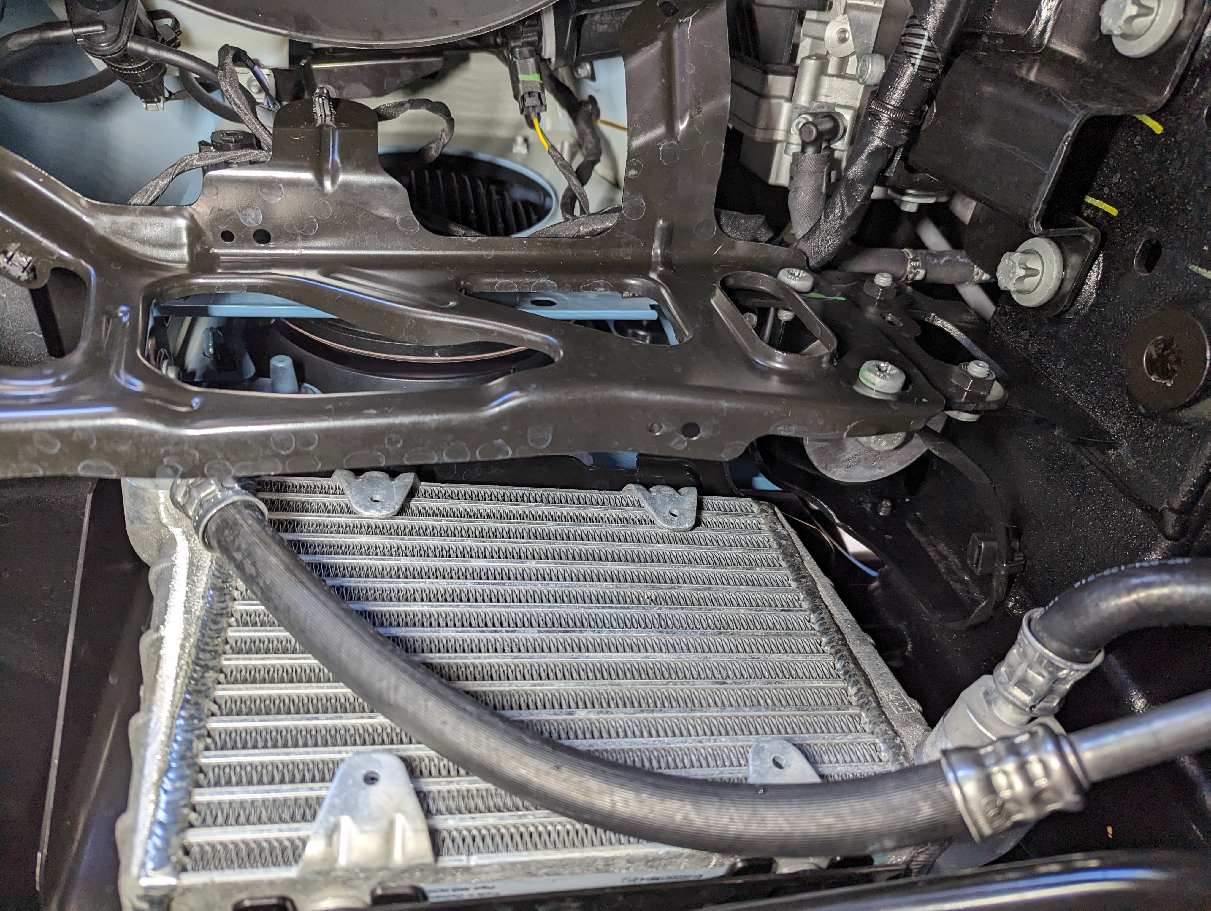

This is my transfer case cooler on the LHS. No fan. PS pump visible top right.

Hmm.. perhaps I now need to start a thread on why is my electric fan so darn loud. I need to learn how to take video and upload it.
