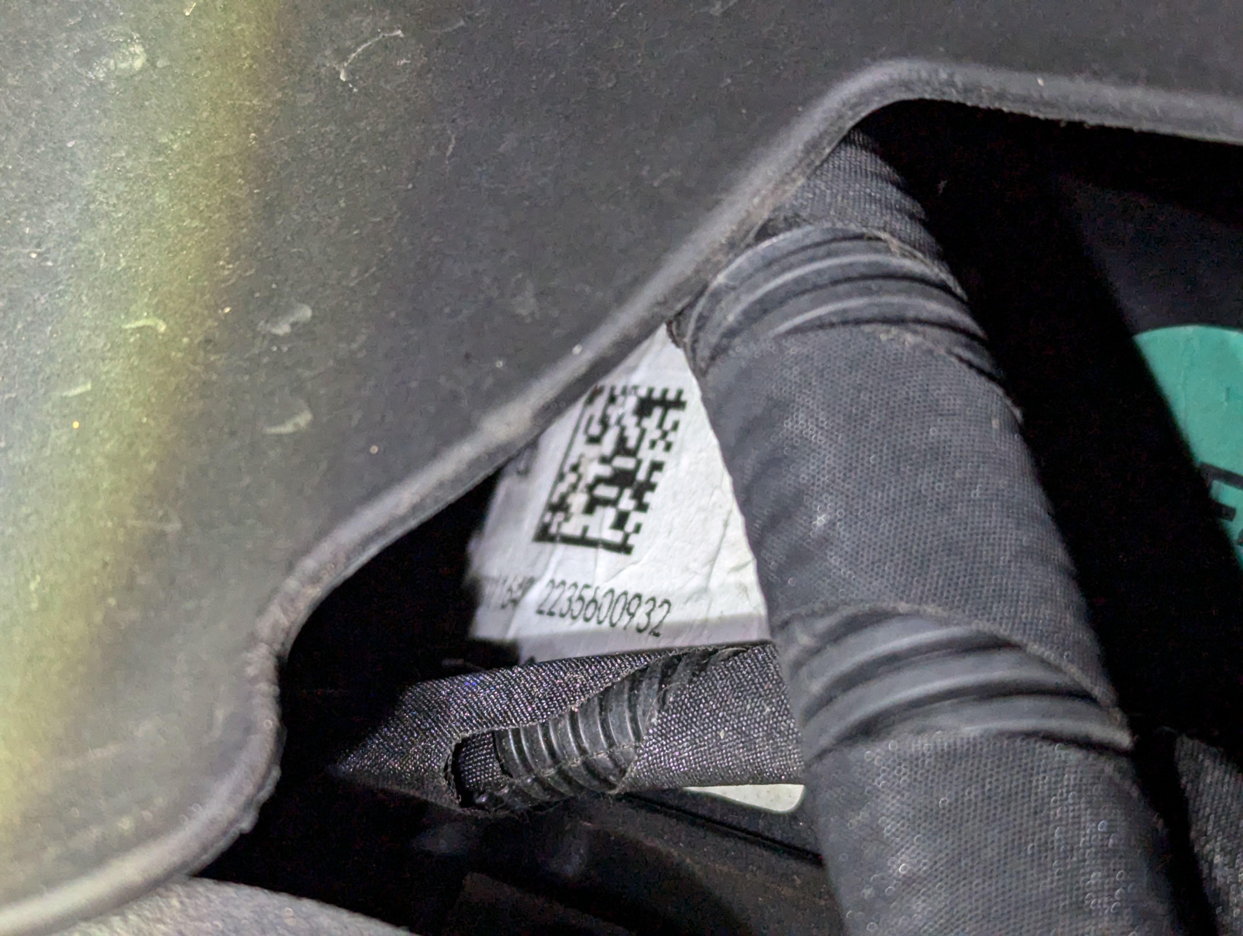

Can you snap a photo of the pump motor? Im curious if the sticker on it has a diff part # that mine.
For the discussion, here's a couple of partial PNs from my MY23. It's hard to get good pics in-situ.
VIN #1886. I think the build month was Feb 2023.
I do wonder when does an operating characteristic cross over to a fault? The electric motor and pump assembly appears to be a 1000 watt 83 amp 12v brushless DC motor driving a pump rated at 12MPa (1740psi) and 11 litres/min flow. One of these units. High pressure and low flow. That's not going to be quiet without some acoustic insulation.
