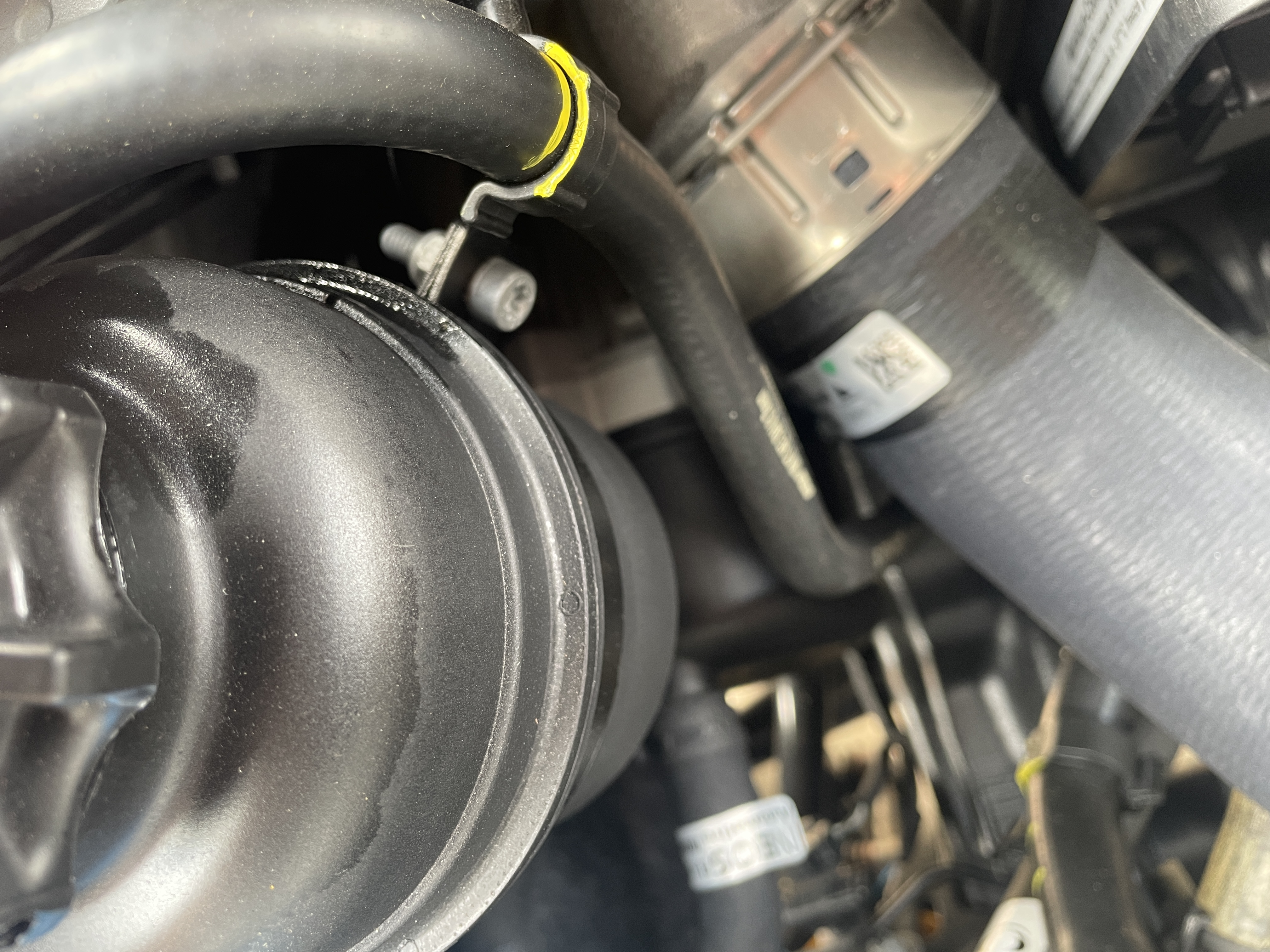

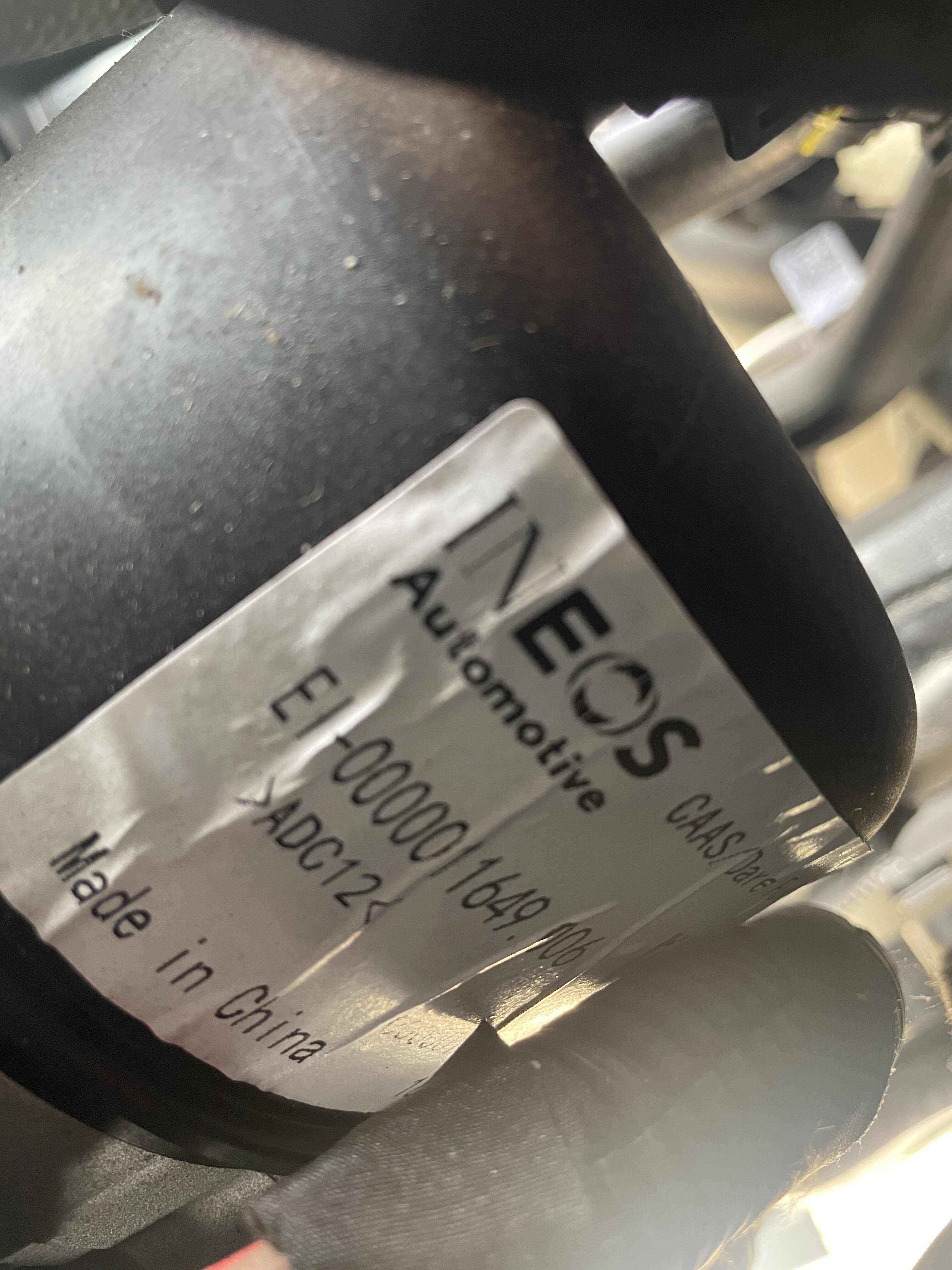

Can you snap a photo of the pump motor? Im curious if the sticker on it has a diff part # that mine.
You check and let us know. Mines at the dealer at the moment.
