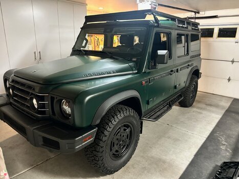

I just stopped by my dealer and listened to three other vehicles on the the lot and tried to replicate my noise. All had a very mild and consistent hiss but nothing nearly as loud as what mine puts out. I told the service manger "hey, I WISH mine made this level of noise". Unfortunately, I was not driving my IG and will bring it back for comparison and demonstrate that I am not just being whiney about it. I did not get a warm fuzzy that anything would be done but will certainly give them a chance. They have been super great to work with otherwise.
@Skydance - How did you fix yours?
As a calibration exercise...is this what other owners that have the condition are hearing? Do I win a prize for the squealiest PSP?
Mine squeals but is not nearly this loud. It is moderate enough on my Grenadier that I only occasionally notice it. Seriously, what is with the variability between vehicles. Optimized engineering and a dialed build process should prevent this from happening. This equally applies to the steering differences between vehicles.
Thanks for the reply. So I'm not crazy about the sound level. I get that these beasts are somewhat like snowflakes in their build variation but I would still love to know the root cause. Air in the lines? Pump pressure issue? Change in pump suppliers? Hose leak (although no evidence of that)? Surely a bright fluid systems engineer can pinpoint to the source and fix.
Other than this PSP issue, the build is going nicely and I do love the thing!
I was alone and rocking the steering back and forth about 1/2" right-left-right. The noise lingers after the steering wheel stops as shown in the open hood vid. When it stopped, I went back and just rotated the steering wheel once about an inch and the noise started back right away.
