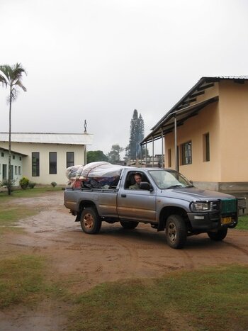

The bumper moving is what happened to my Hilux in 2010. Whilst in a container to Mozambique the webbing straps broke and the vehicle rattled around in the container. During loading/unloading the bumper moved causing bull bar to push into grill and creasing the bonnet, and that bumper didn’t have
