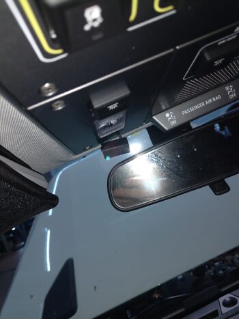

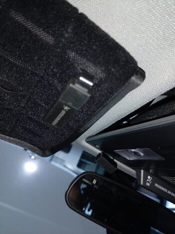

One part of the bad sound quality for the people on the other end of a phone call is, that the Background noise from engine, vibration, and so on travels directly through every hard parts and plastics. There ist no barrier between the mics and the Rest of the body. In addition, they are Set Back a little from the Opening in the panel and pointed straight down, Not at the driver.
A little improvement is to let the mics Hang Out of the roof panel. Background noise is noticeably less loud than before. A little bit Like rebalancing the Sound-Levels of an equilizer. Maybe not looking nice, but hey...
There is even a Bosch Car Service in Germany, selling Hand-Made, fitting adapter-cables to reposition the two mics. E.g. left and right of the rear View mirror.
