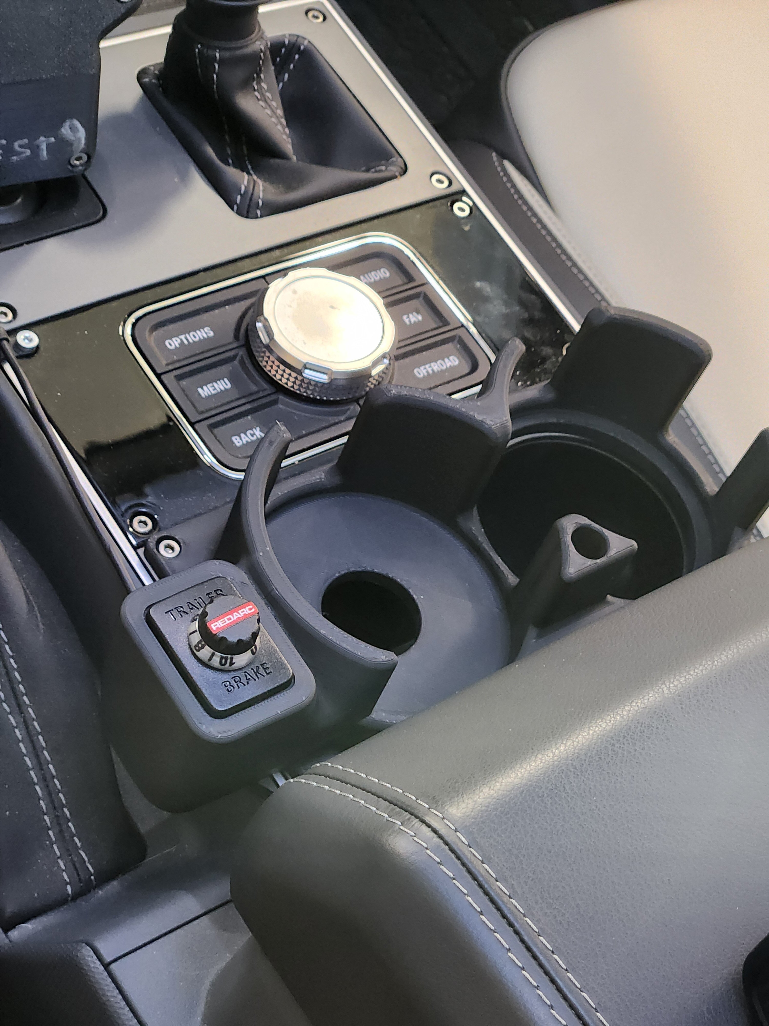

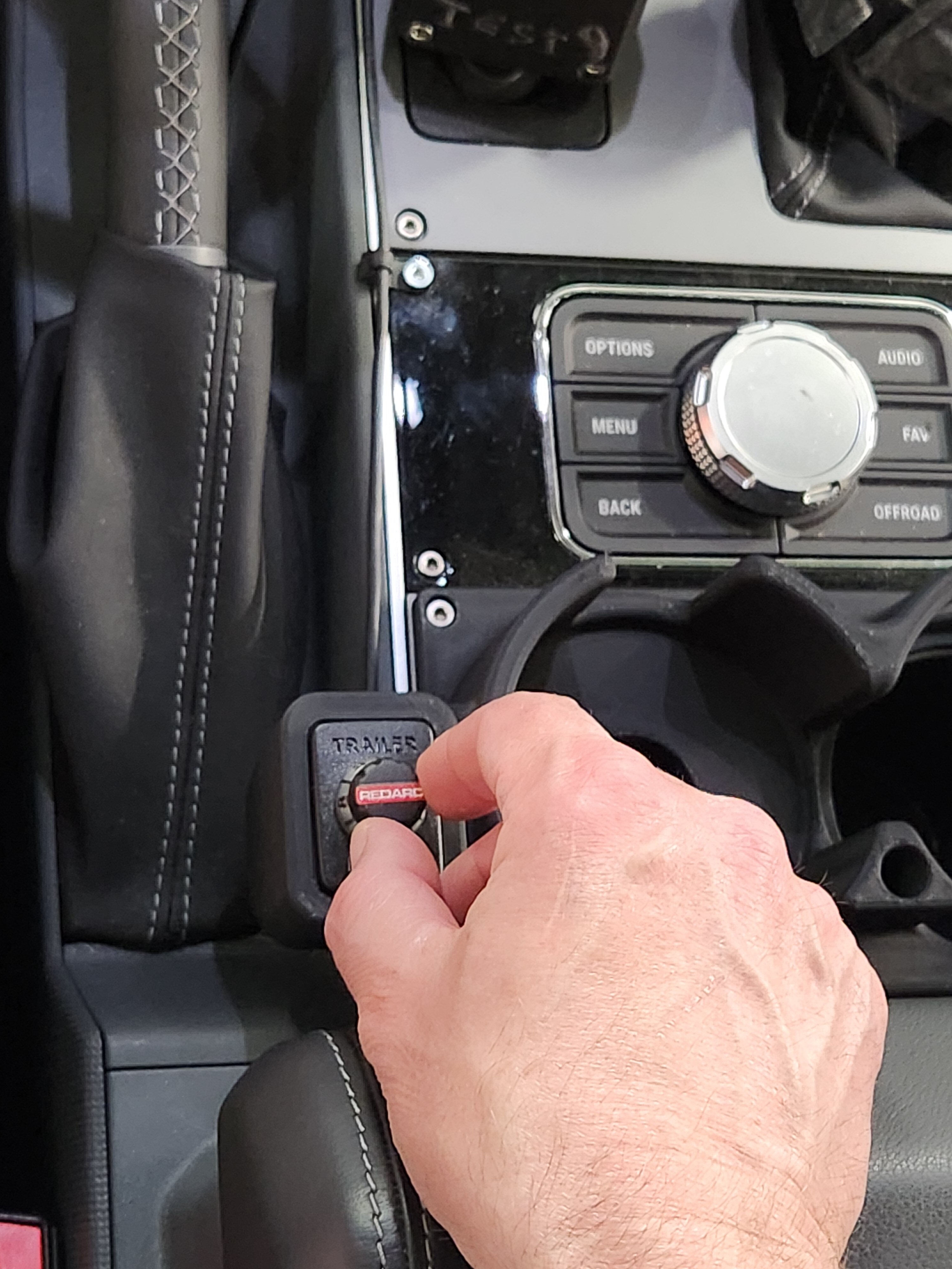

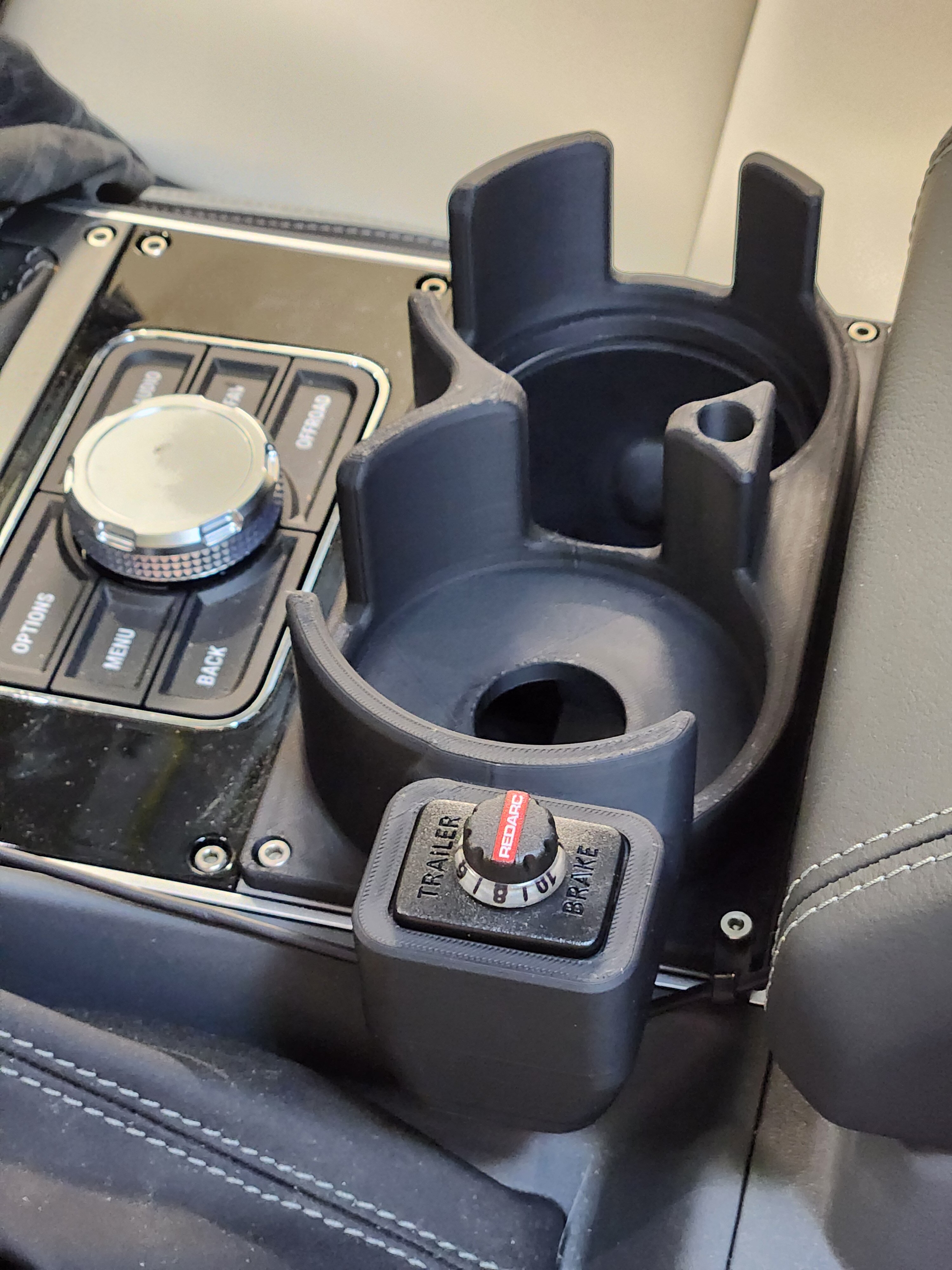

Thought I would post my Redarc Tow-Pro Elite "Remote Head Assembly" (control knob) mounting solution here on this thread.
I didn't want to drill holes in interior panels if I didn't have to. I had already designed this 3D-printed cup holder overlay and installed it on my console. There is an un-used area near the e-brake pivot that seemed perfect for locating the Remote Head. I added a snap-in mount location to the side of the cup holder and I'm very happy with the result. It is easy to see and operate, but it is recessed well below the console cubby lid so it is not easily bumped by accident.
I made the mount so that the Remote Head snaps into place when mounted in the included Redarc "Switch Insert Panel", and the wire routes directly back towards the rear seat under the floor panels. I still needed to buy the 6.5ft extended wiring kit from Redarc (kit comes with 3ft), but that easily reached to the Main Unit mounted under the back seat near the factory trailer brake controller wires.
I will make this STL file available in the forum Resources section if there is interest.

This is super cool. I have the cup mount which is amazing already but do you think you could leave both sides open like you have on the passenger side. With the lip on it it still holds a Nalgene perfect but I can’t put a coffee on the other side. That leaves my wife thirsty.
