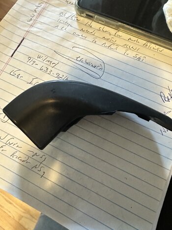

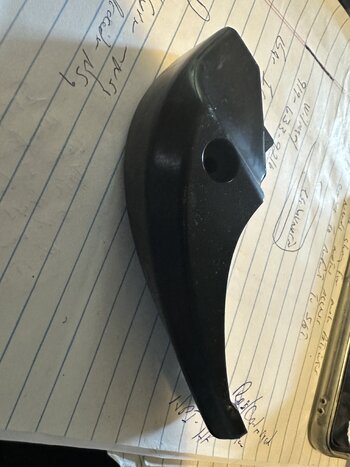

New one for the collective: left hand, front side , where the roof gutter ends. Theres a rubber piece that wraps around towards the windshield.
It popped off whilst giving the buggy a good scrubbing. Appears there is a retaining pin/screw/ grommit has gone missing.
Can someone see what they have on their vehicle so I know what to try and replace?

The 2025 models don't even have this rubber part. I'm not sure it does anything.

Here is a picture from a dealer's website of a 2025. Notice that there is no upper rubber windshield trim.
Probably 18 + months ago I posted on this forum that this rubber piece with thin channel required regularly cleaning with a piece of plastci wire, and an occasional removal and scrubbing. Front and rear,
And a marine grade S/S screw to hold in place.
Pour water into your gutter and see where it ends up. You may get a hatful ;<)
Where, is there full instructions. I've never removed or changed any screws
It appears to do little more than collect bugs and debris between it and the metal gutter.
It's just a single screw accessible from the underside. I've considered using silicone to seal it in place and then removing the ones at the rear to encourage all water to drain rearward. I'm not sure it would have the effect I want when parked nose down.
