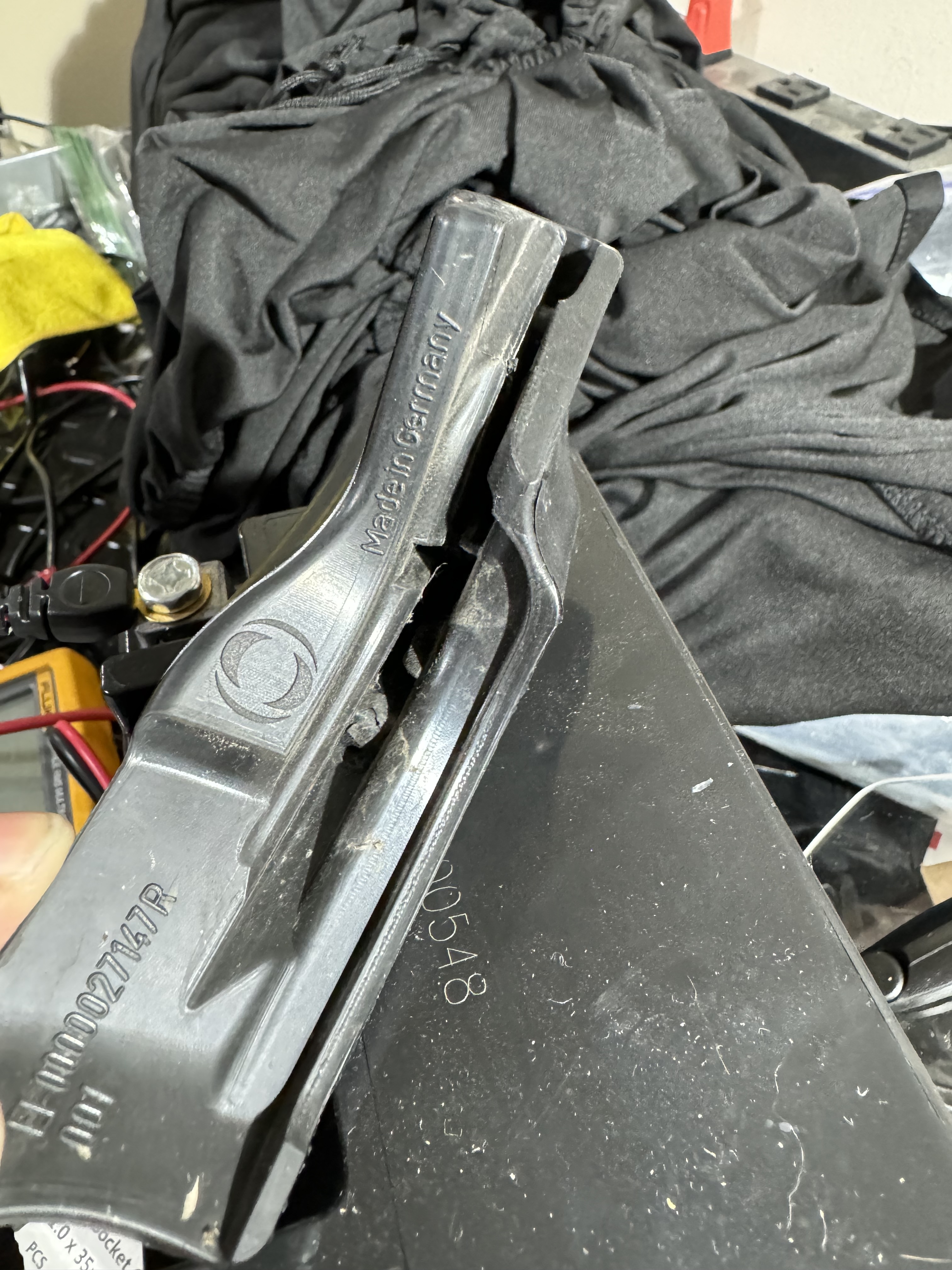

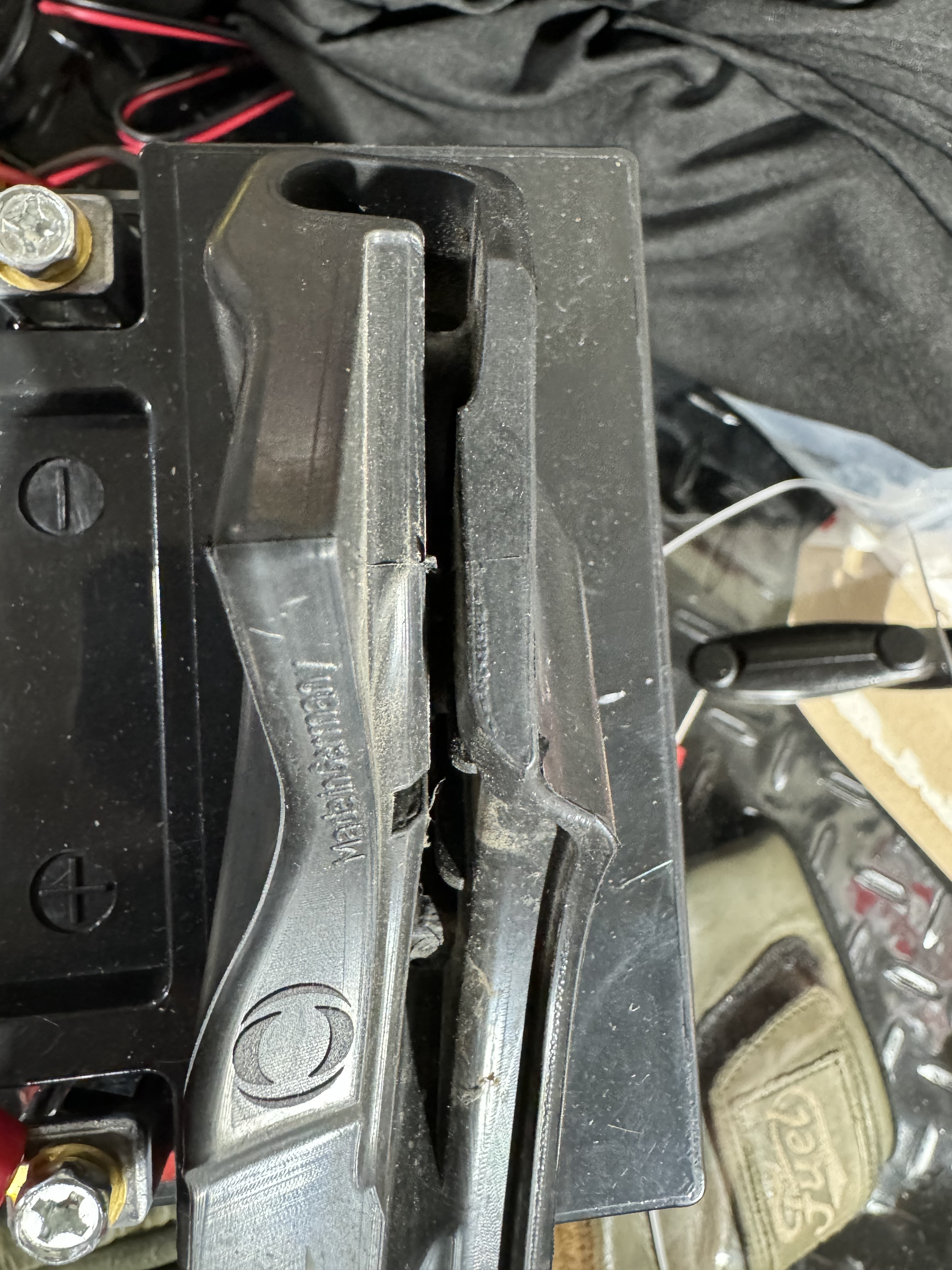

Ok. It is def a design flaw. I pulled the rubber corner piece off the (US) drivers side. First pic you can see built in diverted that look like their job is to push water towards the front windshield/screen. I removed the diverters as I noticed there was also some billed through of rubber which was also removed. Not sure it’s going to work but if it is the solution it’s an easy fix.
more better pics

Appreciate the videos and the photos here. But regardless of whether that rubber gutter trim is working properly or not to divert water toward the windshield, it's my opinion that water coming down the A-pillar should not make its way into the cabin. That in itself is a design flaw imo. In any vehicle, turning on a hose down the A-pillar should not result in water entering the cabin or collect in the door no? Or is it me?

I agree, but I think these areas of the gaskets (because of their limitations) are impacted by water piling up at a stop. It fills the areas and then the doors are opened and the water dumps. I added some silicone caulk as well. My calling skills suck but I think this will work.
The good news is caulk pulls off once the experiment proves a cure. However, it might be a temporary workaround until Ineos fix the problem properly.

I ripped out the first diverter with needle nose pliers and then shortened the second one 50%.
