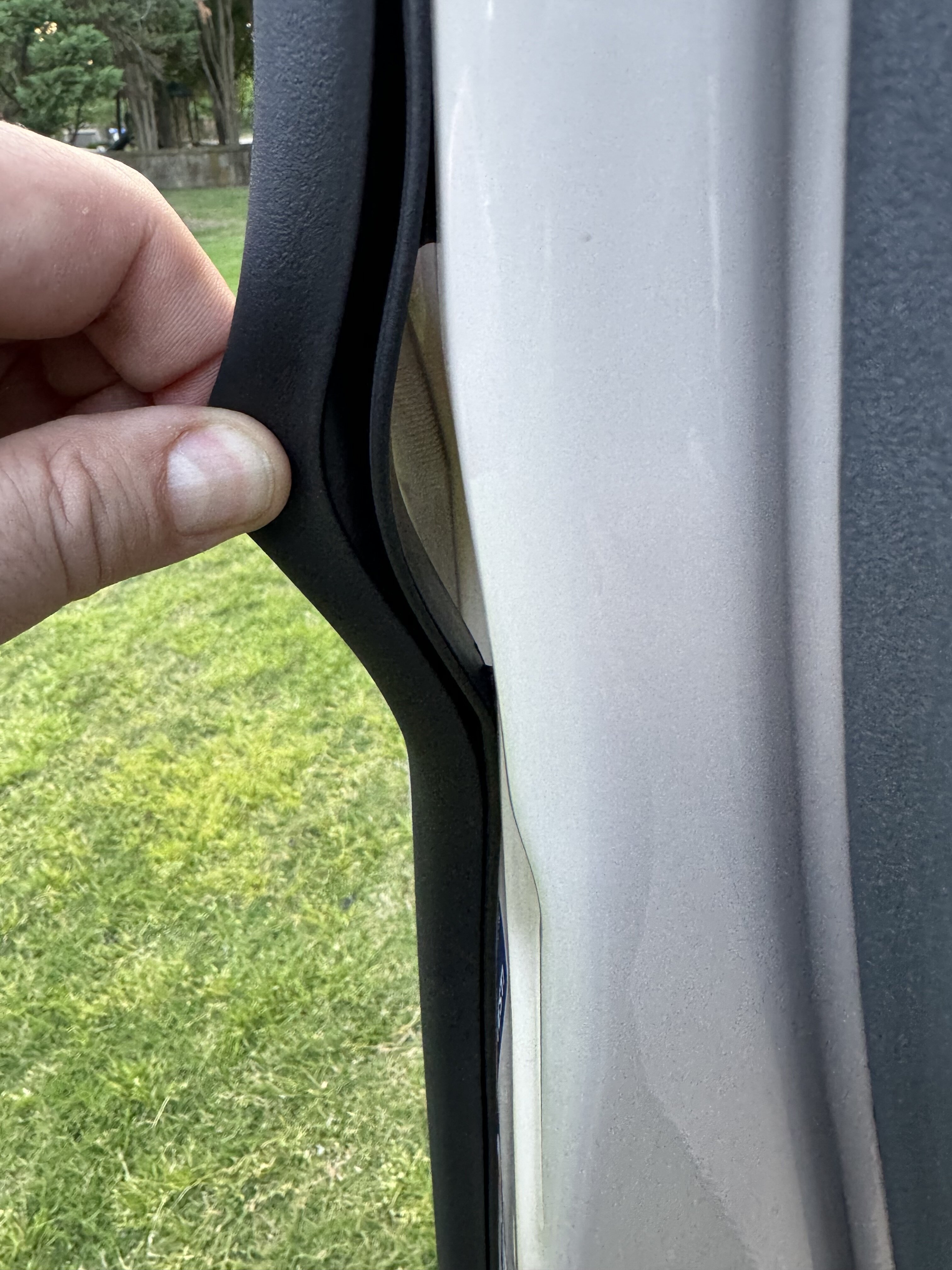

You guessed rightly. To their credit they are trying to be supportive. They say the usual dealer things "we can only do what Ineos directs us to do" etc. Amusingly the loaner has the same rear door seal issue and the steering is badly off center. I sent the service director photos. He was surprised and said I was the first to notice the rear door seal issue.
I've attached the photos I took the loaner. If you get black gunk on the door and the rear seal is tacky and looks like this photo you have the same issue.

Out of interest I went and inspected the loaner I have. A Trailmaster with 600 miles on the clock. Here is what I found. Both front doors and both rear doors.
There simply is zero adhesive applied in the places that they are not fixed. They claimed it was not cleaning the doors that caused them to come away, but this is simply a lack of anything adhesive. There is no tack or residue.
Some of the thumbnails are not rendering as I post, but if you click them the full image is there.
