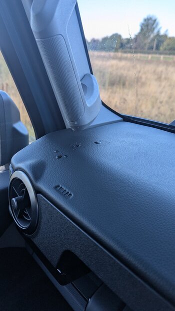

That brings me to the situation this morning. I get in the car for the school run to find this.
Looks like at least the windscreen passenger side top corner is leaking. The footwell carpet is wet. But where is the water coming from that results in it dripping off the a pillar grab handle (?)

bugger. do you have safaris?
Yup. I had what I thought was a good sniff about and it didn't feel like it was coming from the safari(?) but I could be wrong.
Assuming it's coming through the safari, it would be making it's way through the headlining all the way... What might that mean for all the electricals up there, and around the area ( not to mention rust trap and soggy insulation)
Quite difficult to tell unless blatantly obvious, though definitely a weak point on some vehicles. Jean Mercier I think had some trouble with his early on. There's a drain hole etc that can become plugged. Various threads on it. Could also be a poorly bonded windscreen in that top left corner. Good luck and hope get sorted asap.
