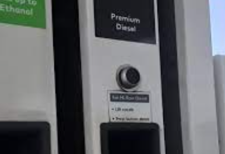

I am finding more fuel stations have a standard size nozzle and a "press button for hi-flow" option.

I had tried to obtain this genuine VDub adaptor a couple of times but it was always out of stock. Currently available from Amazon. Cost me A$36.69. Delivered in 12 days ex-USA.
Length 135mm
Filler end OD 25mm (bottom)
Nozzle end ID 42mm (top)
Nozzle recess depth 25mm
Haven't used it yet. I expect it will take some trigger whispering to refuel without blow back or nozzle cut-off.
Reminder: You only need a solution like this if you're refuelling a diesel Grenadier from a hi-flow pump that is fitted with a large diameter nozzle, as is often found at truck fuel stops in Australia.
