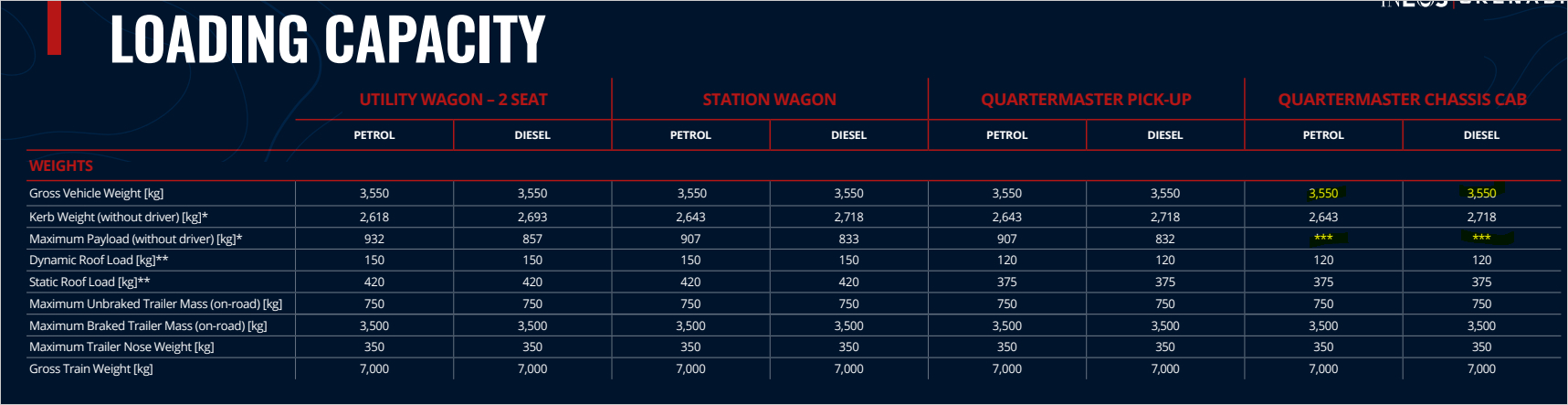

It will be limited to 3500kg GVWR for the European market for it to be eligible for most car countries car licences. Can be optimistic and hope for The ROW & Australia the GVWR/GCM is around 38-3900kg with no need to spend a fortune for upgrades. The AU brochure shows the chassis cab kerb weight the same as the pick up.

Cab/chassis doesn't have a payload.
There is nowhere to carry a load.
Payload will be determined by what is put on the back
The Quartermaster with that huge heavy tub and 90% fuel tank can carry 907 in petrol and 832 in diesel
I guess the tub probably weighs 150-200 kgs.
Keep in mind also that the standard GVM in Australia is 3550 kg not 3500 as in rest of the world.

Ineos should of at least printed the cab chassis correct kerb weight with out the tub so a buyer knows what they can work with for up fitting unless there are some unspecified changes to the c/c making it the same kerb weight as the pickup.
