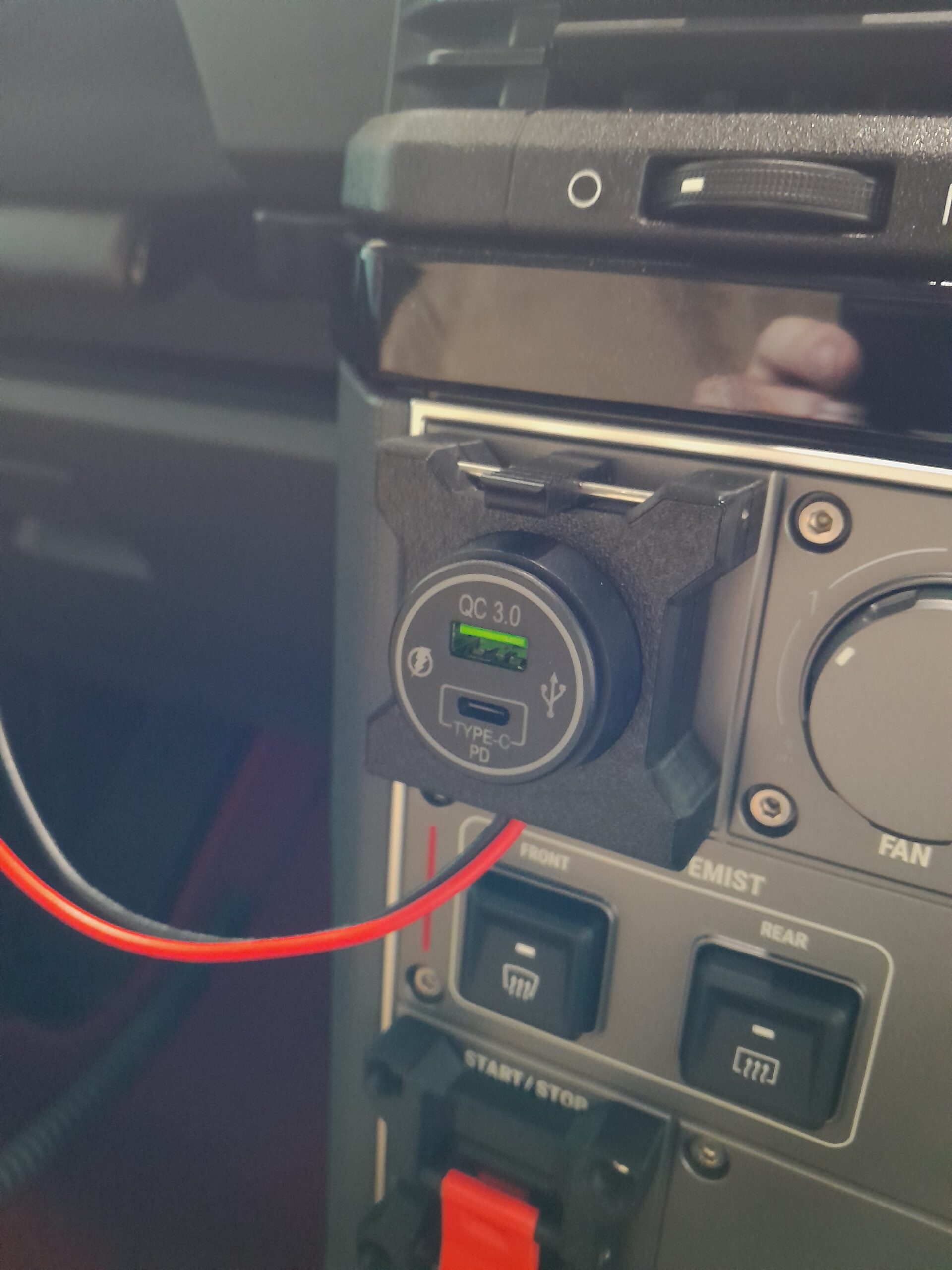

I found a much neater solution that did require a bit more work. Worst part was trying to establish if there was sufficient free & clear space behind without ruining anything….. there is.
I did take install pics but can’t find them at the moment so will update later.

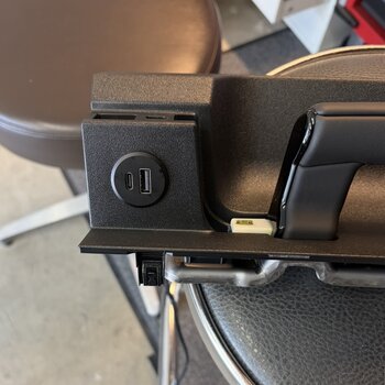

There is also also space on passenger side grab handle. Out of the way and not very obvious.
