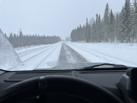

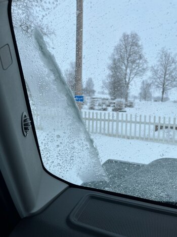

Of course when I went to take the truck in, it was working fine (got up to -16C), but they did the procedure anyway, It's in the cab so not sure why there is a coating on the terminals, but they leaned them up and the HVAC seems to be working fine.
