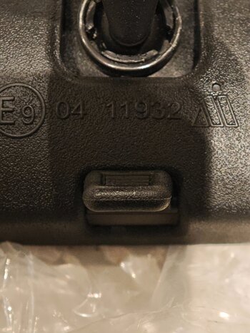

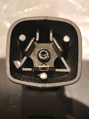

I have removed mine in my 23 car with a chassis number in the 2000's. If I remember correctly it was a quarter turn but it was stiff to start. I can send a photo of the removed mirror so you can see the back if it will help you.
If you want to remove both mirror and arm then yes, you turn the arm anti clockwise but you will probably need to use a pair of grips and protect the finish on the arm with a cloth or something similar.
Thanks for the confirmation, I have the wolfbox arm and adapter so hopefully it goes well.
That would be great just to confirm everything

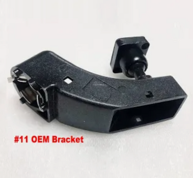

I tried a similar kit before identifying and buying the Aliexpress arm. The adapter dimensions were not right and they were too flimsy to support the weight of the Wolfbox screen which is much heavier than a standard mirror.
The supplied Wolfbox arm doesn't place the mirrow low enough to clear the airbag panel or be able to plug the wires in. I spent a lot of time finding a drop arm to move the mirror lower.

Hi, thank you for the precious insight.
Has anyone got this info? What would be the ball diameter on the original Ineos bracket, once the original mirror is removed?
