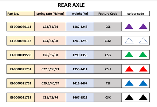

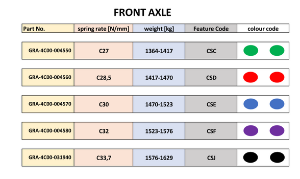

Do you know what factory springs you have installed currently? Ineos installs specific sets depending on how the vehicle is optioned/built to account for different component weights and use scenarios. For example, if you have a winch on the front or opted for a tow package you are going to get higher rated springs at either end.
In theory, you could go to the softer end of the range of springs Ineos offers but you’d be putting limitations on the amount of weight you can carry if your vehicle is heavily optioned. Most folk here are going the opposite direction and looking for more load capacity with higher rated coils and control with upgraded shocks.
There are quite a few spring threads floating around the forum and some show color charts where you can identify the springs you have based on color coded markings and part numbers on the coils.
