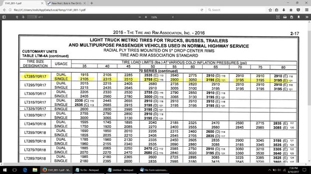

BFG load chart + CAT scale weigh-in is what I use. No guessing required.
