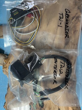

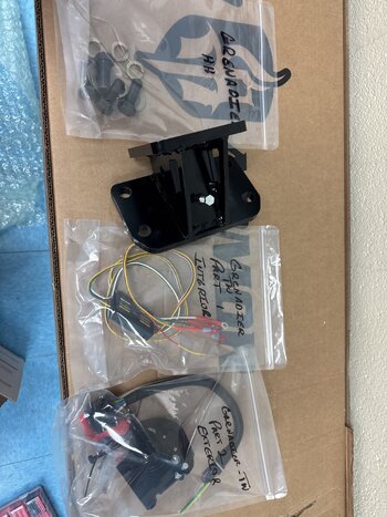

I'm bit unsure why but my order doesn't have the towing hitch. I'm pretty shocked by that I must have accidentally not selected it when running other options. Anyone do the same and add one after the fact? I guess so long as the framing is there it's not that hard. Just wire a harness into the rear tail lights.
I have the tow hitch and wiring available.
820.00 for the kit
Or
Hitch 395.00
Wiring 425.00 ,
We’ve sold and or installed over a 100 units without flaw.

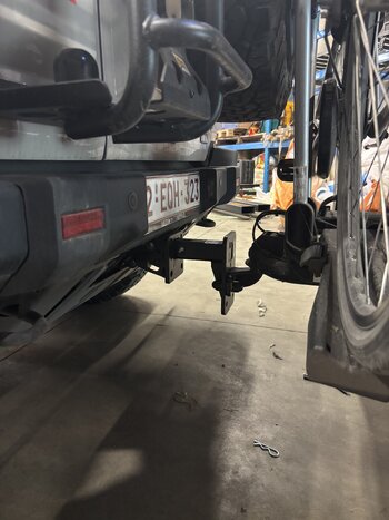

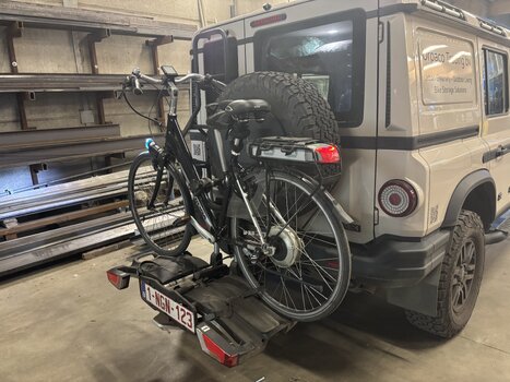

Yes, M16 Metric fine wire. Already installed the hitch, but still have to do the wiring for the lights. Also need to adapt the tow hitch to shift the bike rack a bit more backwards to get my bikes on without the spare wheel interfering.
Just need to dril an extra hole, as the bikes have no extremely weight and that I aint pulling anything that should be ok. When I want to pull a trailer, I put the hitch back in to the original position.
