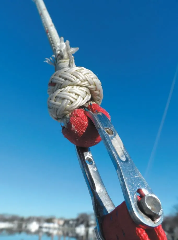

The issue with using this on a naked loop is that it will stress the dyneema, correct fitment would be to a loop which is supported by a thimble.
To be clear, one can go to a chandlery/hardware, buy a suitable thimble and whipping twine and adapt the loop, likely without needing to re-splice it.
I agree that a rope supported by a thimble is best, especially the closed types; but there's some interesting thoughts/observations on using thimbles, the ratio of the rope diameter (D) to the diameter of the shackle pin (d), thimble or other attachment point:
There's also the question of knowing if the rope provided is heat set or not?
Oh, interesting:
High molecular polyethylene (HMPE): Slippery HMPE fibers (such as Dyneema) share the load better, since they can easily slip over each other. Like nylon, when the D:d ratio = 1, the strength of the eye is undiminished. Because the line diameter and the pin diameter are generally about equal strength in applications that use Dyneema, no thimble is required. Heat-set Dyneema, used for standing rigging, is a special case, and should have a thimble or ring.
…so here regarded as necessary for a typical hook, but perhaps not essential for a pin of equal or greater diameter than the 11mm line.
Which suits me as the shackle I’m interested in has a 16mm pin. Thanks for sharing that.
