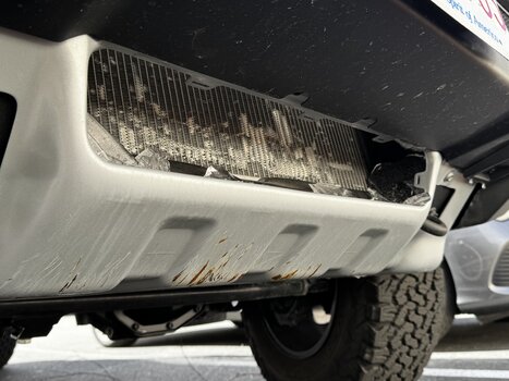

Front skid plate inadequate - radiator damaged from icy water crossing.

Please be aware that if you are navigating an icy water crossing, the front skid plate acts as an ice scoop and directs chunks of ice directly into the radiator. I am fortunate that only the fins are bent, and that none of the tubes are compromised. I am going to research aftermarket skid plate options, or may just have a plate welded over to blank off the ice scoop in this one. If radiator airflow becomes an issue - we will see.
This would also potentially be a major problem driving in thick brush. The factory plastic guard which covers this opening is of little help.

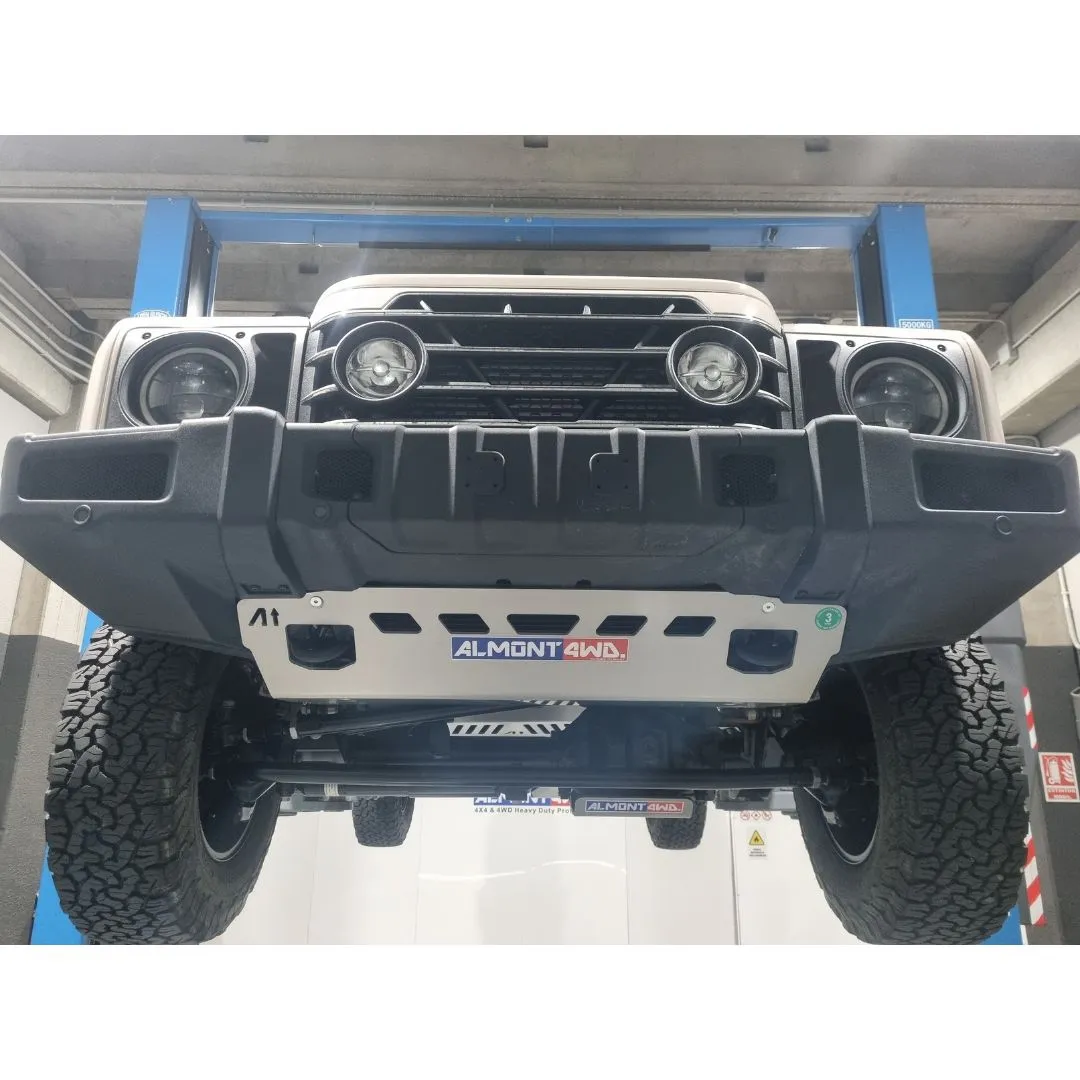

Signature and I believe agile offer front skid plates.

Back in Dec 2023, there was an INEOS event with ~70 Grenadiers, where nearly all of them went through icy water, many of them twice or 3 times. No obvious damages.
I agree that the front grilles are not as sturdy as they could be. Reducing speed may help...

Could you let us know which skid plate you choose. Agile is developing theirs, available in a few weeks. I am interested also.
I have been wondering why no one offers replacement front and rear bash plates. After having the front plate off this past weekend I was pretty impressed with how sturdy these are for a sheetmetal bash plate.
Speed was not a factor. Creeping pace, breaking through 3/4 inch thick ice on top of about 20” of water. Probably about directly at front skid plate opening height. If another vehicle had passed before me, it likely would not have been as much of an issue.
i saw agiles plate over the weekend. its a beast of a plate. extremely strong. double walled for extra protection in key areas.

I have ordered Agile's new front skid plate.
