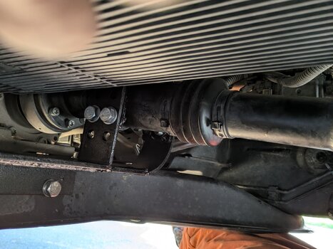

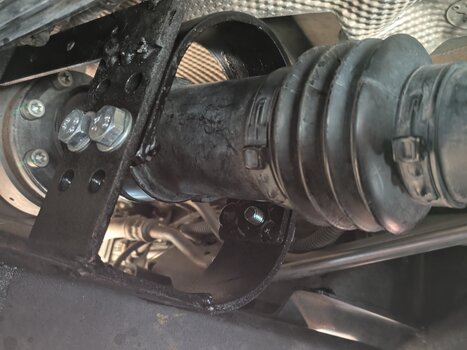

In situ

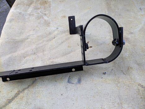

A little bit rough, could have done better.

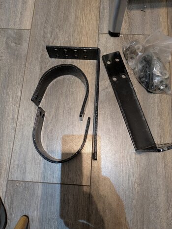

Actually just a £31 driveshaft retaining loop from Amazon chopped up a bit (some blood lost in the process)
Of course I had to get one of these to made sure nothing clashed
