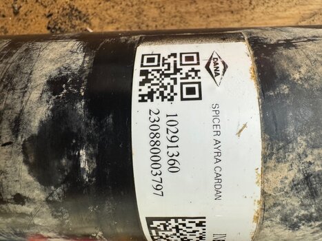

Has anyone been able to confirm from a reliable source if the replacement part number for the front driveshaft has been changed or superseded? Likewise, for late 2025/26 production models does it show a part number difference when compared to previous production models? I know we keep asking IA to talk about how they are going to address this issue but a quiet part number change is about as vocal as they are likely to get about any updates.
I was told by my agent the part number is different. I'll post the part number of my new one when received. They do not know at this stage whether any of the design has been changed. I will put them side by side if possible and photo.
Old broken one part number for ref;
Note: I inspected underneath mine fully before my trip north where it let go. No vibration or noise evident prior to failure.
