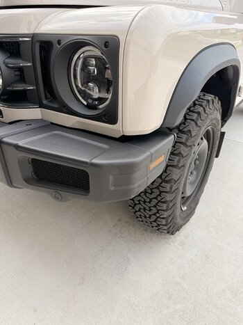

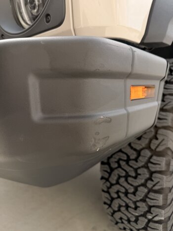

Anyone know the part number for this? Think I'm better off just trying to sand it and respray? Seems like a pretty easy install for a new one. I don't have access to manuals yet. Any help is appreciated.

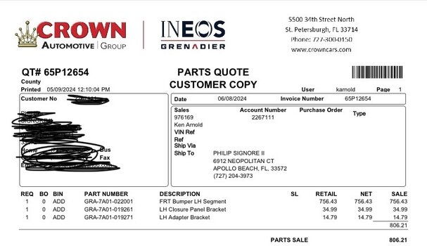

Post above is the correct part, but get ready to spend $750 on it. I bent mine backwards and looked at replacing it, but ended up replacing the rear bracket in purple in that pic above and that was only like $35, and then I used a pry bar to bend the bumper back into place

I had the same thing happen to my rear (AUS Metal) bumper. I just sanded back the powder coat and painted with a mixture of black and gray paint to match. I asked our local dealer to find out the proper paint code for the bumpers and Ineos said "if it is damaged, it should be replaced". Lol! It's just a flesh wound after all...
I just brushed and the bumper is fine but the adapter plate bent. When I disassembled it there was a another bracket behind it between the plastic and the purple piece. Can some one look at the system and see if MY25 Quartermaster requires an added piece. Looking to buy the pieces and fix the front driver side bumper.
