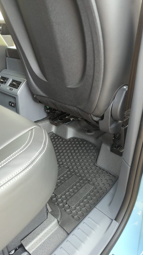

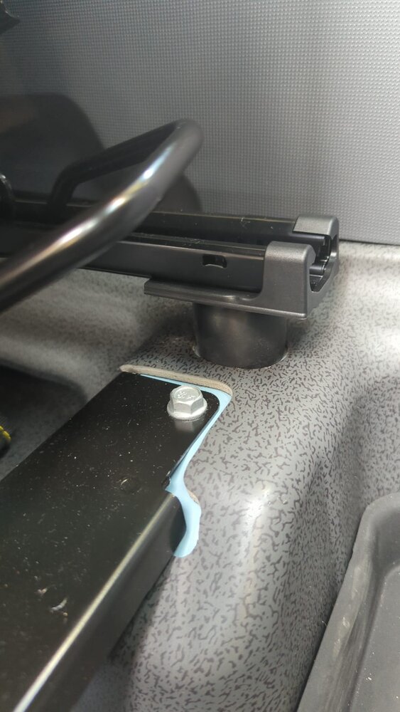

Please take a few photos and post them up, I can't be the only one interested in how you've done this. 🙏
EDIT- Pics uploaded 35mm higher
here is a link to the spacers for now:-
40x40 spacers
I used some 12.9 grade 65mm M10 bolts but had these already.
I am not sure if the spacers are ideal they seem solid enough but compress quite a bit when doing them up. I did put high strength threadlocker on the bolts as wel just to make sure they can’t come loose. I will probably get some stainless spacers at some point, also amazon can’t be the cheapest place to buy them but the super quick delivery does help.
40x40 spacers
I found the seat suited me as high as possible, I wonder if the extra height that you have added would work for me too. I do find the that the Sun Visor blocks too much of the road at Max height for me though.
joejet
1:44 PM
Jun 3, 2022
263
632
Far far away
So by putting in the spacers it allows roughly the same height as max (well you can go higher) but the seat is now further back, as it moves forward when you make it higher on the pump.

Good job Joejet (I keep wanting the write Jo Jo Zep & and Falacons!!) to try it out but, I think if you wanted a the more permanant solution then a full length metal spacer that sit underneath the seat rails (see photo) .
I think this would be more stable and secure, especially in a hard brake, crash situation. This has been used in other cars as an accessory for short drivers that need a lift.
Just this for placement - not a photo of the spacer.
What I mean is remove the rubber spacers and instead insert a tubular light steel, drill holes for the seat bolts.
