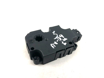

Doing some investigation into those actuators, looks like they might be a MAHLE (might be a resupply from another manufacturer) part used in Audis, and probably many other makes.

How many degrees did the actuator rotate when looking through the bore scope?
How many degrees of rotation does it take to open and close the valve on the spare unit?
Could it be the the actuator and valve are not zero'd at assembly? So the actuator can not either fully open or fully close the valve, depend on the mismatch at assembly.
Do you have the ability to drive the actuator on the spare unit?

Badger4x4, I'm going to check this ad get back to you. I think it's around 90 degrees. The actuators have a power input and two other wires, which likely indicate extent of travel. I've dealt with this before in my Jeep WJ which has a whole heap of HVAC issues.
Blackwolf, I will produce a sketch, although what I don't know is exactly how the air flow control affects the actuators - that is something of a guess, although it's not a hard one. Thanks for your comment! I will try to help out as best I can with any questions about this, but bear in mind that I'm not an automotive engineer, so some very technical questions may be above my pay grade.
The four wires are power, ground, LIN in and LIN out. LIN is a one wire bidirectional serial bus used for automotive communications between components where full CAN would be overkill. In this case, the in and out terminals are used to daisy chain the stepper motors / actuators.
The CCU module generates the LIN messages which can be used to command the valves to move to any position. It also controls the PTC heater, reads the various temperature sensors and a few other ancillary tasks.
