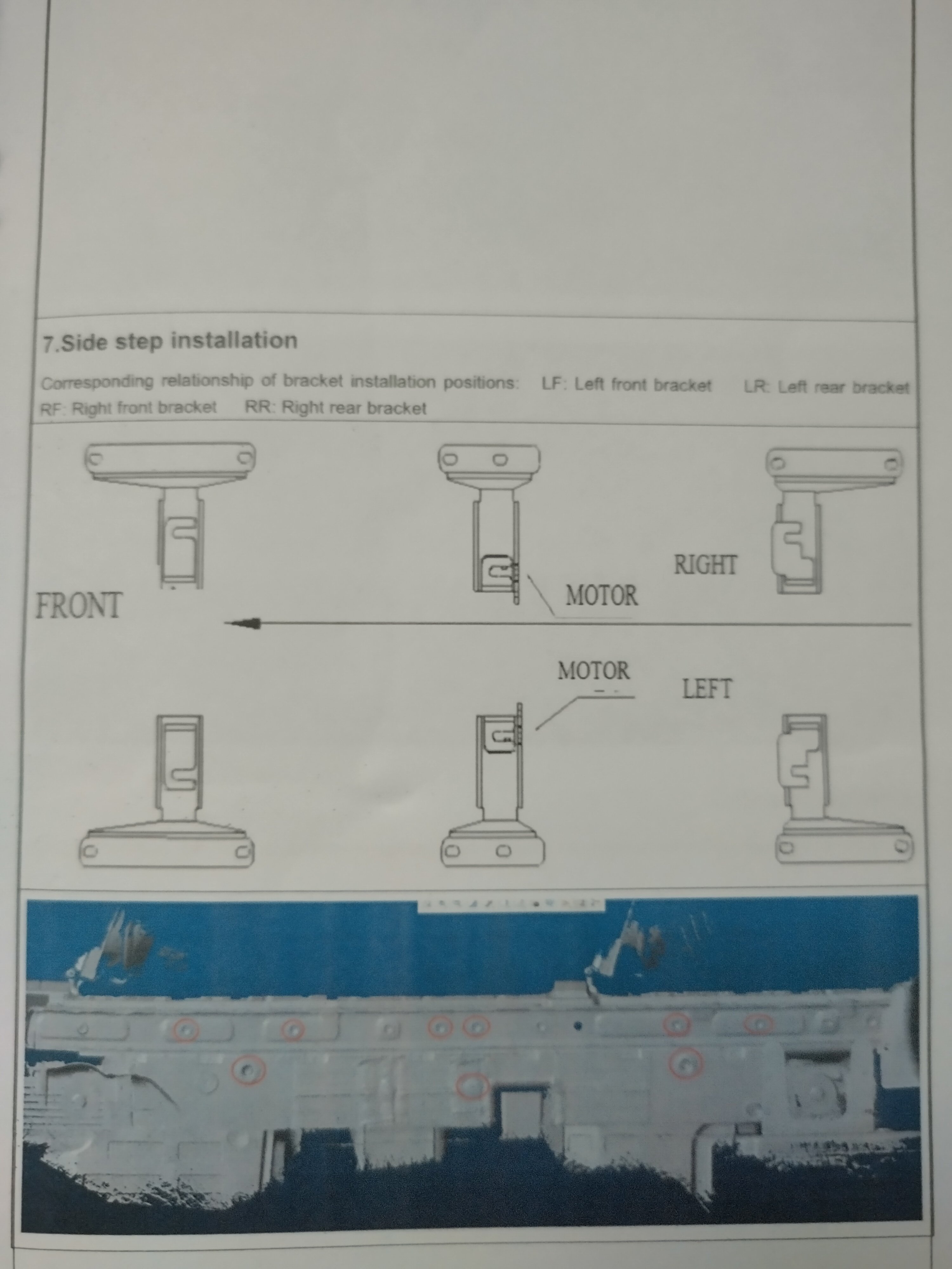

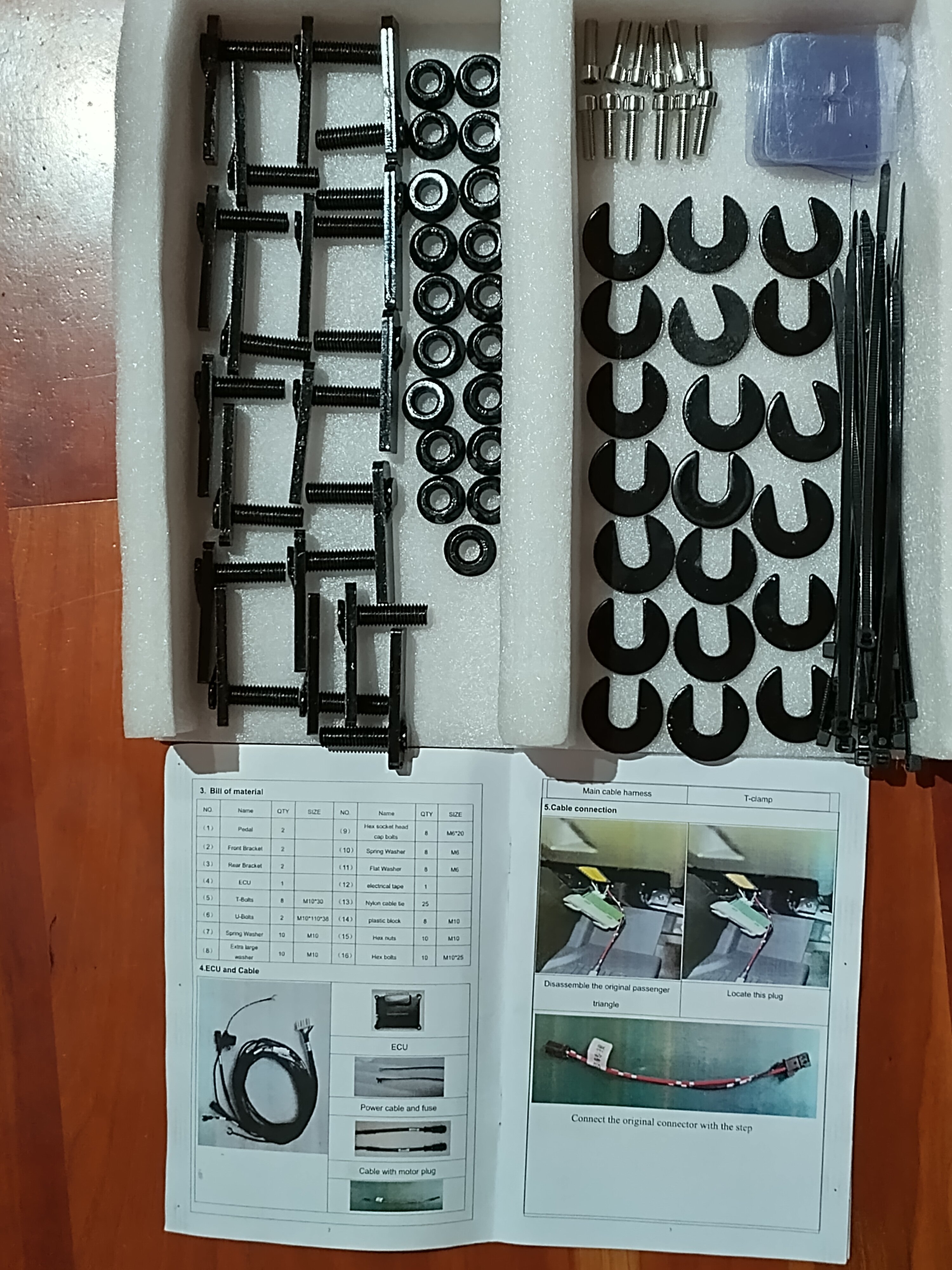

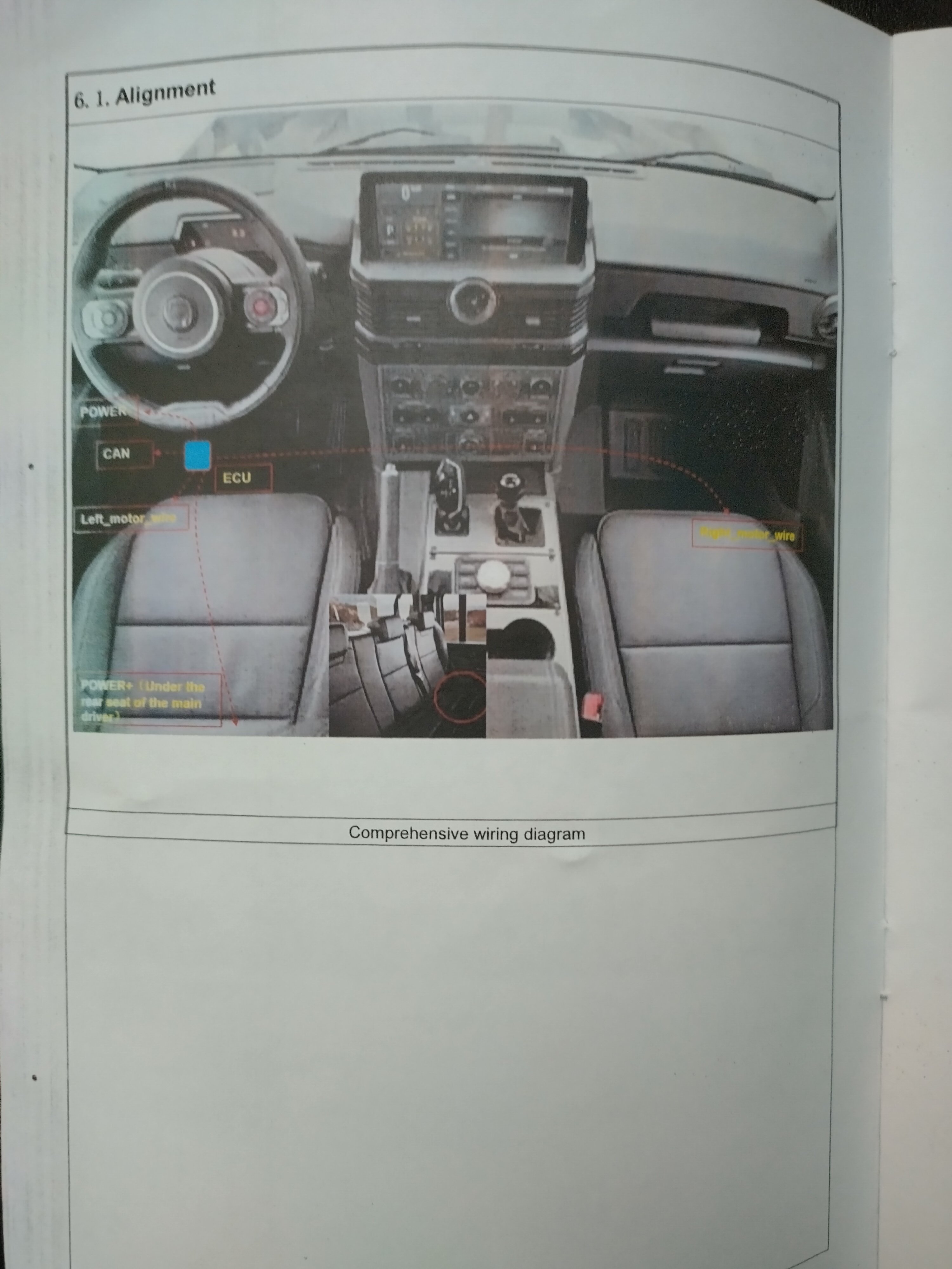

Instructions for actual install of motors to frame is pitiful, however instructions for electrical wiring is much better:

Update: Reached out to Summer as the parts sent do not match the instructions. instead of the mix of M10 and M6 Bolts, Hex Bolts etc, I was sent 20 M10*20 L - Bolts & U washers , 25 plastic 'cards' and some zip ties.
Edit: omgosh, no idea what happened there with the attachments.
So Summer got back to me and basically told not an issue.. talk about %^$# instructions. Nothing about providing updated instructions etc.
A couple questions if you don't mind. Regarding installation, how do the brackets bolt to the frame/chassis? Do you have to remove some plugs and fish the L-shaped bolts up into the chassis? If so, are there any concerns regarding water intrusion (especially in the winter with salt on the roads)?
Very Good questions indeed, that's where I'm at right about now. Not much help from Summer. Will keep you all up to date. (I plan on taking lots of photos)
