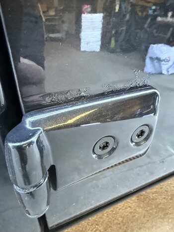

Spotted this the other day, looks like corrosion under the paint coat l/hand rear door..
Looks like another thing to get sorted when it goes in to get the “over due service” error fixed 🤷‍♂️
Anyone else got any corrosion on the body panels?

Looks galvanic. Think the hinge is steel as well as the fixing but can’t remember if the door is aluminium.

Nah those are just shitty bolts. No bearing on the rest of the car.

To the OP, that is not normal and shouldn’t happen (assuming the hinges and bolts have never been removed or loosened.
On the OP’s image does that look like a razor blade scratch just above the hinge? Could this be a case of faulty PPF install and they scratched the paint trimming the film around the hinge plate?
Presume this was a new car, not one that might have had a repaired rear hit?
They’ve not been touched, it’s my second vehicle so it spend most of its time under shelter 🤷‍♂️

That is bad - I would 100% address this with the dealer and make a warranty claim. I’ve not seen body panel issues like that on the Forum - maybe I missed it
I have some corrosion on the hinges themselves which they have agreed to replace, and I know another member who has just had his rear hinges replaced under warranty for the same thing.
Concerning to see what looks like galvanic action on the door itself.
