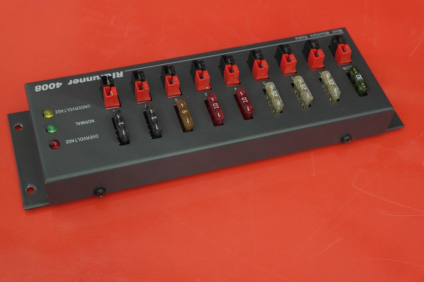

Having read all of these posts I am (as I had always intended) going to take a direct feed from the battery (second one in my case) an run it through a separately fused power distribution box (Rigrunner) in order to power essentially anything I want.
Once we get the actual wiring figured out on the vehicle, those will be a bonus!

That is a really useful piece of information - many thanks for this - I will use this with a distribution box (probably switched in line as well). Really grateful.
