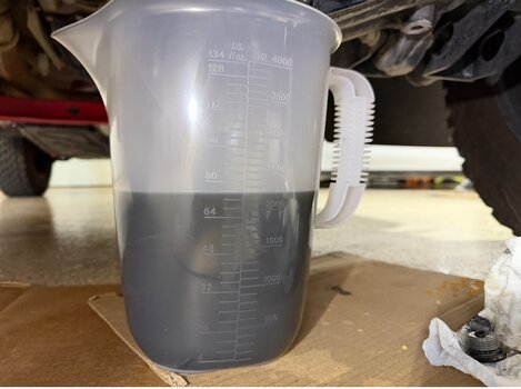

I just changed mine using Titan 80w90. The front had 2.1L and the rear about 2.05L. I filled both with 2.1L. The oil looked pretty clean (only have less than 5000 miles).
