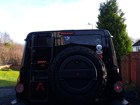

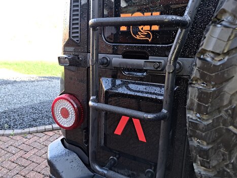

We added the Buzz Rigid back lights. Didn't wire them into the reverse as wanted to be able to use when required. wired through EXT3.
Think they are reasonably discrete until you turn them on, then they are very effective.

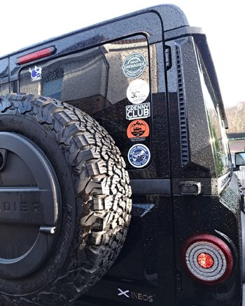

Mine on the left. Couple of Lazer lights wired into each respective sides electrical socket. I turn on the corresponding ext switch when needed for reversing. Or flick the pwr switch on as well for working when ignition off. Just remember to flick both off!
