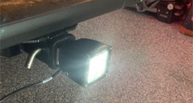

It might not suit, but a simple solution is a light that fits into the trailer hitch and takes the power using a trailer plug.
