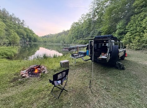

I’m looking for some advice regarding rear spring setup on my Grenadier. I currently have a 2.5” lift in the front, but the rear sits noticeably lower.
Not sure if it’s just the lift difference or if the rear springs can’t handle the weight I’m carrying. Right now, the rear is loaded with a spare tire, a roof rack with two storage boxes, and a drawer system in the cargo area — total constant weight is probably just under 200 kg (around 440 lbs).
I’m considering switching to either the Eibach 500# or 1000# rear springs (Grenadier-specific), possibly 500# with a Metalcloak spacer if needed.
Main goal is to level out the stance — or even raise the rear a bit higher than level to account for added weight during trips or when passengers are on board, so it stays balanced under load.
Has anyone tried either the 500# or 1000# Eibach springs on their Grenadier?
Would love to hear your experience or recommendations.
Thanks in advance!

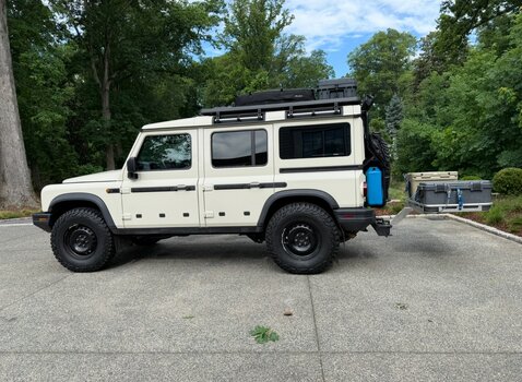

Great looking rig Heekis. I’m actually having the 500# springs installed on my grenadier right now by David at Design Build Go. We should be able to share some feedback in a week or so. I have the 1.7” Eibach lift on the front and started with the 1.2” rear to try and level the vehicle. Unfortunately, with the weight I have (similar setup to you, but a little heavier) it sat down in the back. I considered the 1000# springs, but was concerned it might be too stiff unless it’s fully loaded, so we decided to try the 500# springs along with air suspension bags from Airbag Man. If you are not familiar, they fit within the springs and can be inflated to a higher psi when the wagon is loaded to tighten the suspension and keep the rear lifted.
Here’s a pic with the standard Eibach springs. David measured it at about 3/4” low in the back, and that’s mostly unloaded. Happy to share another pic and our feedback once we get the 500# springs and air bags installed.

I have not put it on the scales, but it would definitely have been a more technical approach. I did quantify all the added weight I’m carrying above stock. In addition to the weight I’m carrying in the wagon, I also carry a Pakmule tray on a swing away hitch off the back. The tray is cantilevered off the back, so it is multiplying the weight. Given all this, I thought it was worth playing it safe and adding the bags while we were making the spring change. I have a feeling I’ll need them when fully loaded, but won’t know for sure until we’re done.
We are also changing the shocks to those recommended by Eibach to be used with the 500# springs. We were going to go with the Fox shocks, but switched to the Eibach Pro Truck shocks at their recommendation when we went to the HD springs.
Attached is a pic from before the lift / HD springs. You can see the Pakmule projecting off the back.

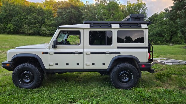

Received the completed pics from David at Design Build Go in Statesville, NC who did the suspension/shock upgrades for me. Pics are of the wagon mostly unloaded, though the Big Country drawers are installed. 20 psi in the bags. Results in an ~ 0.75” rake, which is what we were hoping for. Ride quality report from his test drive was very positive.
- 255/85R17 MT Baja Boss A/T's on factory steelies
- 1.7” Eibach springs on front
- 500# Eibach progressive springs on back
- Eibach Pro Shocks
- Airbag Man airbags
Picking the wagon up Wednesday and will fully load it up and do some testing in the next week or so. Happy to share the results with the group.

Just did a 45 minute ride in various modes including highway. Here is some feedback from the test drive.
Smooth ride on the freeway. No rattles from the drawers. Very stable and predictable. Not much weight transfer during starts or stops which was something I was worried about.
Minimal body roll in cornering. A lot less than stock.
Shocks are effective over pot holes or road deviations much less roll again. We added the Eibach pro truck shocks.
Alignment is on point. Track is on point as well

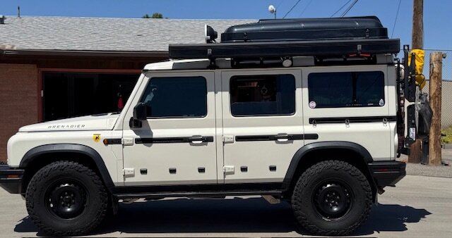

Here’s a shot of 500lb springs in back. Stock winch springs in front on 35” MTs, full fuel, fridge, gear, but missing 75lbs of extra water and fuel and 50lbs of food and clothes, power station and less 20lbs of propane & holder and traction boards, plus with 15ish lbs of hitch and mount I usually remove, but otherwise in camp mode. That’s a lot of plus and minus…sorry. But it’s an idea. I’ll try to get a better pic of fully loaded (7020 lbs all up-full fuel on state scale without people or dogs) If we camp this weekend.
And here it is all up in 7000lb camp mode, 40/60 weight split. I think the 500lb springs are substantially underrated. There’s more than a 1000lbs of gear from the safari windows back to the pull pal, and it looks like stock rake. Only skids and fog lights forward of front seats on stock springs. I should’ve measured the rear fender height before the spring install. However, with the springs, full skids & 35” MT pizza cutters, it’s still super capable with real ground clearance, despite the load.

The front springs are bone stock, factory winch and winch rate and there is only some fog lights and skids forward of the front axle. I have recently added koni raids to the front as well. But there wasn’t a noticeable weight change from stock

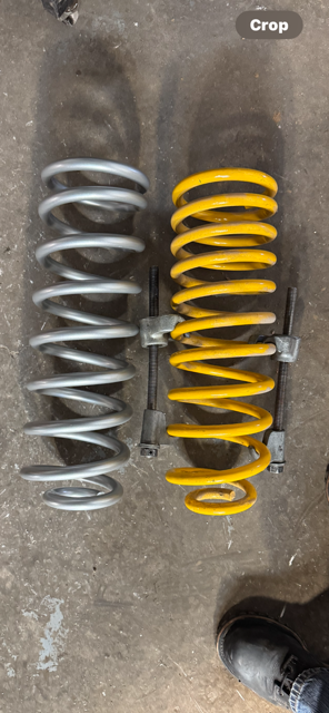

I’m not surprised that the tail sits high even with an extra 1000 lbs added. Those 500 lb. springs sit 2.4 inches higher than the stock springs. Eibach lists these springs to be 1.4 inches higher than the stock units with a 500 lb. load. So even with all the extra weight they will likely still sit a little higher at the rear. IMO …If you go to the 1.2” front spring you should sit pretty level.
Curiously both springs are the same height unloaded as stock. (the compressors have just enough tension to keep em’ from falling off). So it’s odd with way more than 500 on the back it’s still over factory height. I kind of wish they had shortened the length with thicker coils to accomodate a more stock ride height whether loaded or unloaded rather than go this route, or given us an adjustable spring perch to ramp up the preload at a given height.
