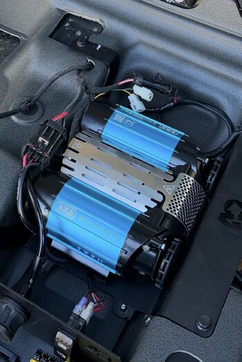

Pics
How I generally put the wires. You’ll notice that the bolts are out of the mount. That’s because I had a pile of the interior panels and didn’t realize that there was one that goes underneath the unit. You can see that one on the right hand side of the picture. It took me a while to figure out where it went. Luckily I figured it out before I put the seat back in.
Pretty much at the full disassembly step. This is when my wife walked out into the garage. It was a three Diet Coke job.
I like the video that they did. The guy definitely knows what he’s doing, but he doesn’t do ninja moves or leave you in the dust. Plus, it’s good to hear him grunting and groaning at certain points.
As I said, I think I over unassembled it.

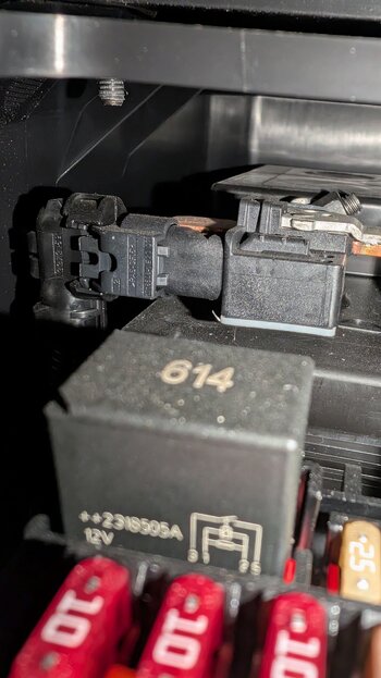

So, I didn’t get the seats error, but I got a check engine light and my ODB had a U00AC error code, along with no info on the Offroad Electrical screen. Hmm, I thought maybe I had juiced the electrical system somehow.
Luckily I had noticed a free connector and took a pic of it whenI was putting everything back together. I thought it was maybe an extra bus for the spare battery. I reached out to John Moore at Red Noland with the symptoms and a pic of the connector (the pic below of it connected). Yep, when I was taking off and putting back on the big black underseat cover I must have pulled it off. Kudos to John for helping me out with some pics of where it should go. I think it is a battery temp sensor.
Got the electrical page back and the check engine light is cleared.
