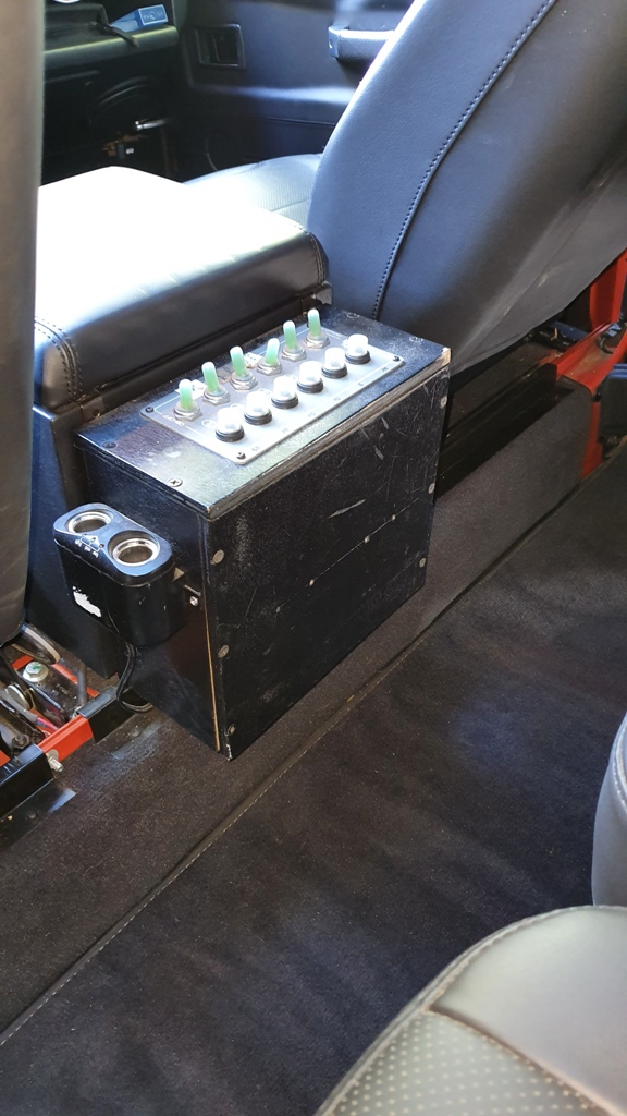

Bonjour,
Le boitier électrique de mon DEF 110 derrière le boîtier Cuby.
Le boitier est relié à la batterie auxiliaire Optima Jaune par l'intermédiaire d'un fusible 40 A.
Toutes les sorties sont équipées d'un disjonteur 12V. Il y a deux nourisses 12V (une de chaque côté) pour l'alimentation des téléphones portables, du frigo de raid, pour recharger les appareils photo.

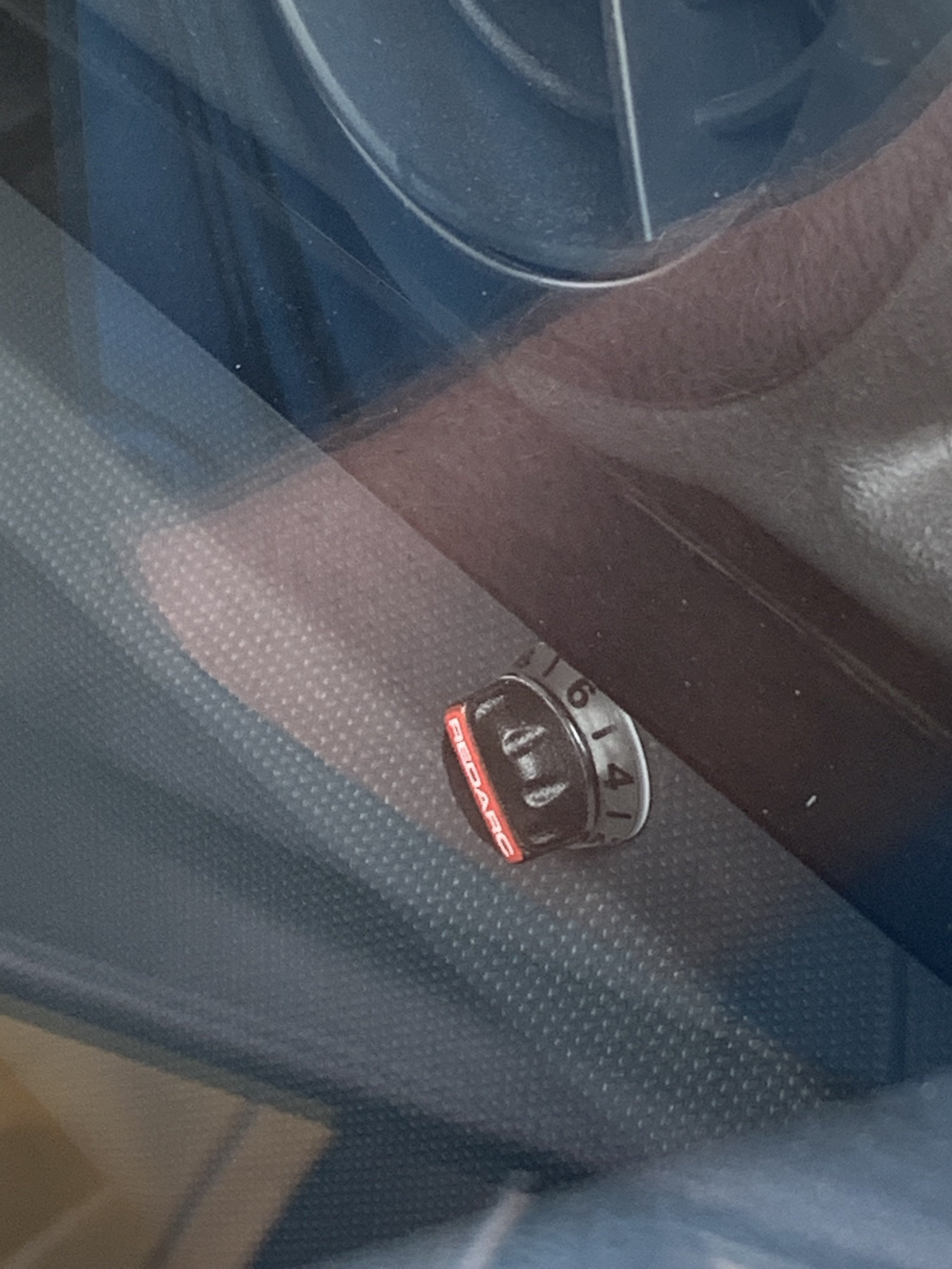

At the Denver event I told them they needed to run a heavy gauge red back to the trailer plug for charging batteries on trailers. Not sure how they took it but seemed interested. I also mentioned an integrated brake controller so as not to screw one under the dash all janky like but they said no on that. They claim 7,000lbs towing but nothing to control the trailer's brakes? Day one adding an aftermarket brake controller will really mess up the aesthetics. Integrated brake controllers with tow pages have been around for over 10 years.
Here is the Redraw one fitted in Australian cars also there is a NATO plug on the back for the winch that could supply power to trailer.REDARC.jpeg
