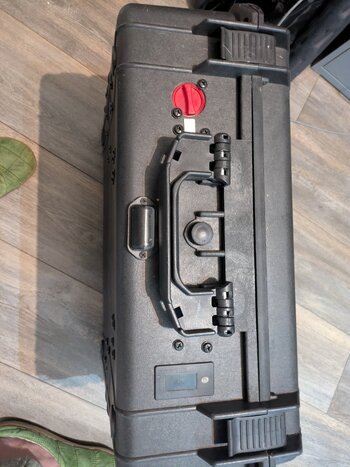

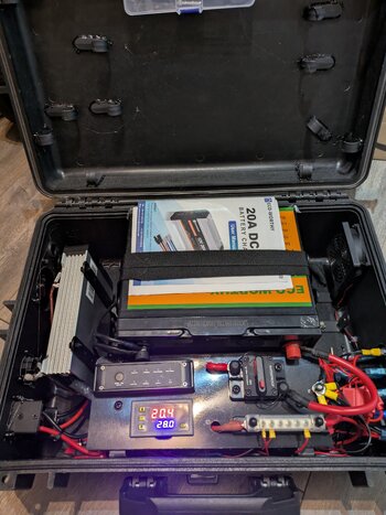

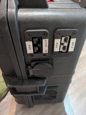

After some thought, I did a self made battery box.
Consisting of a 110Ah LifePo, a combined DC and solar MPPT, plus an inverter. Similar to above, charged by an Anderson fly lead when the vehicle is running.
In a pelican style case it is probably the most flexible solution in that it can stay in the vehicle or go in a tent/trailer/caravan depending on the use.
Or you could buy something ready made from Bluetti or similar.
Sounds interesting, I like portable solutions. . Could you send me some details and pictures of what you’ve made up. I made something up in the past for camping with a bison battery box but before the days of LifePo batteries.
A few images. I went DIY so I could upgrade or change components. Also my thoughts were that a typical off the shelf one would not be repairable when it fails.
At about 18kg, probably a bit heavier than I wanted.
