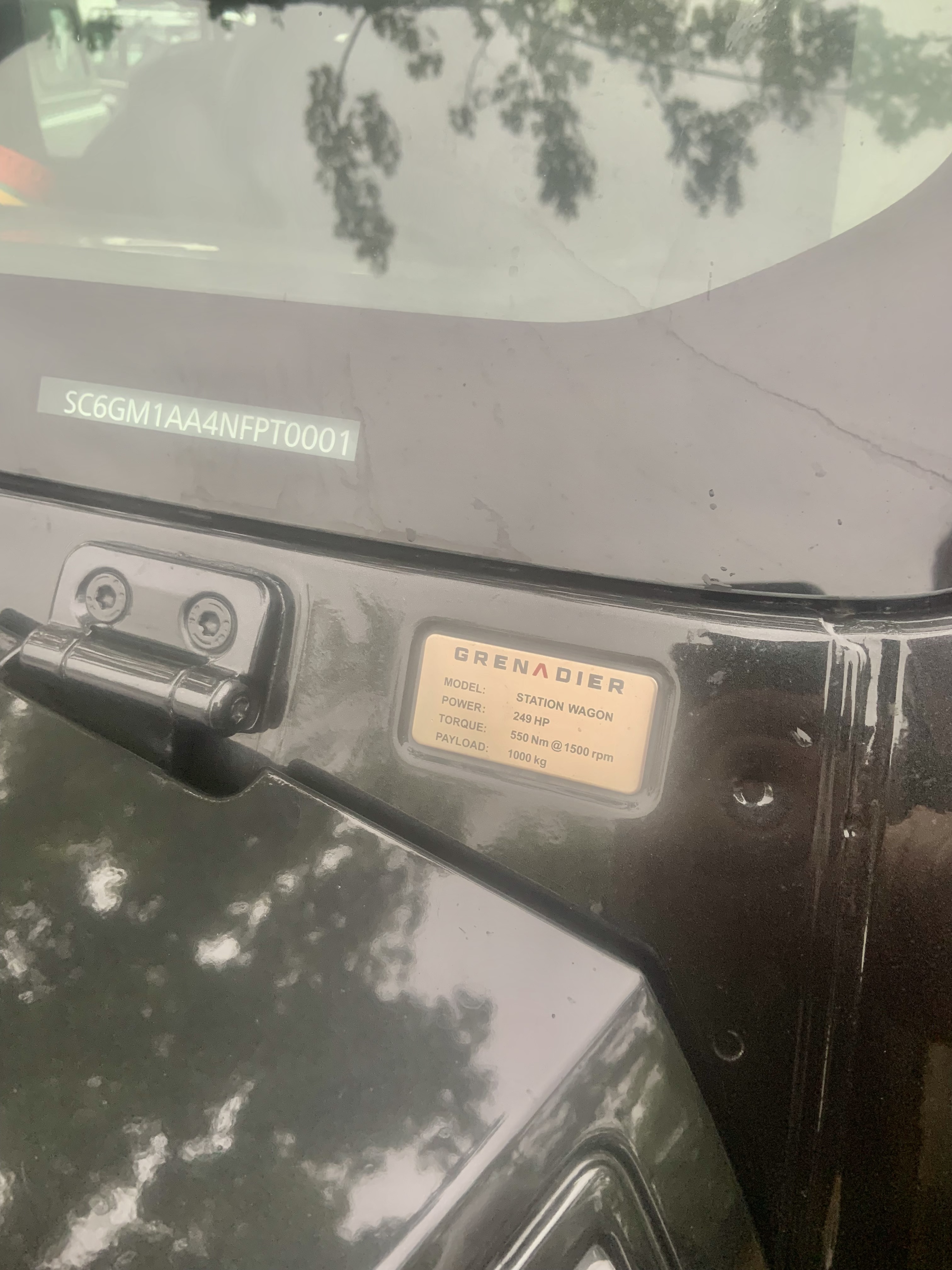

All the pictures where taken yesterday from a blue Ineos Grenadier, which was according to the guys from the dealer, to 99 % production specification .

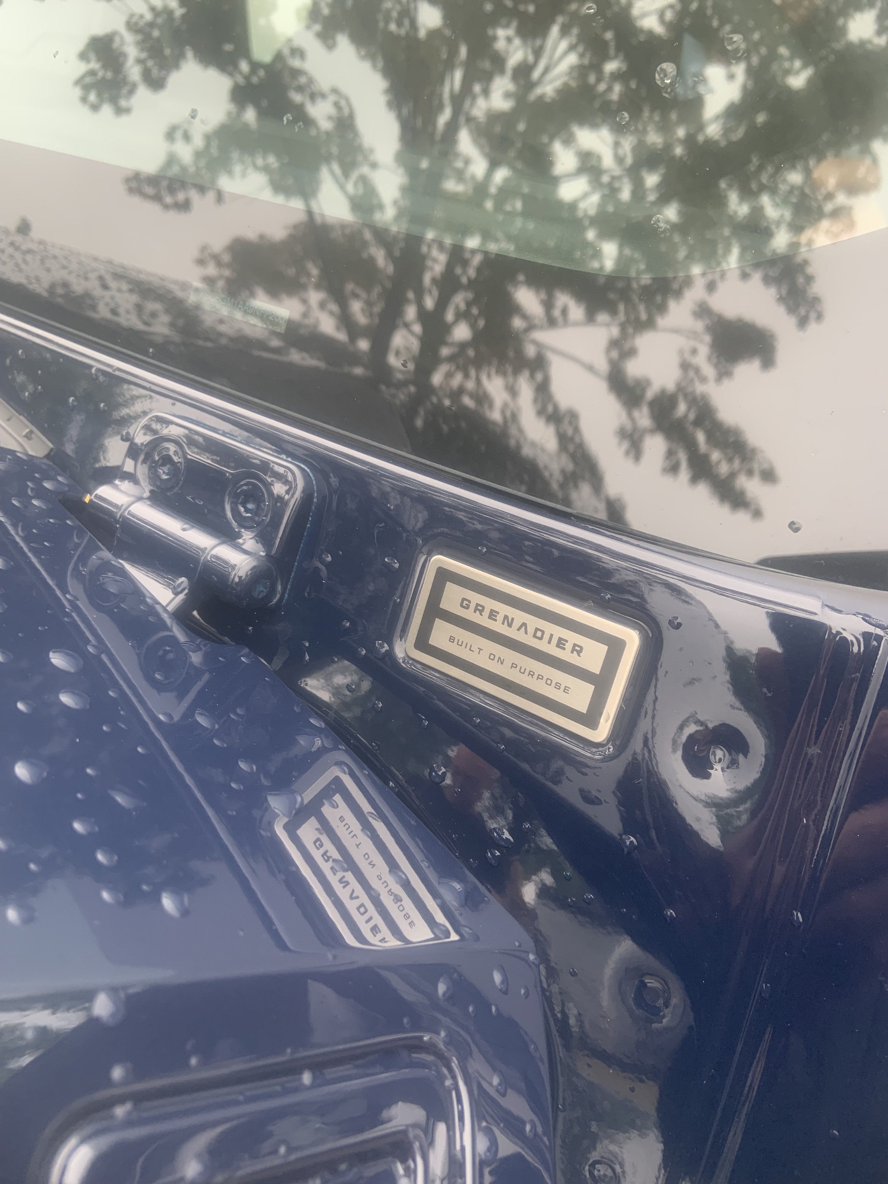

And you seem to have solved the puzzle as to whether non-Belstaff editions will get a front bulkhead badge, and if so what it will say.
I quite like that badge
There was also another badge on Dirk Heilmann's own car
