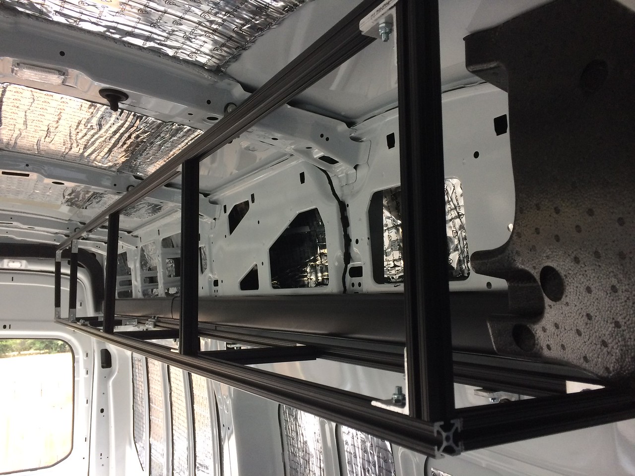

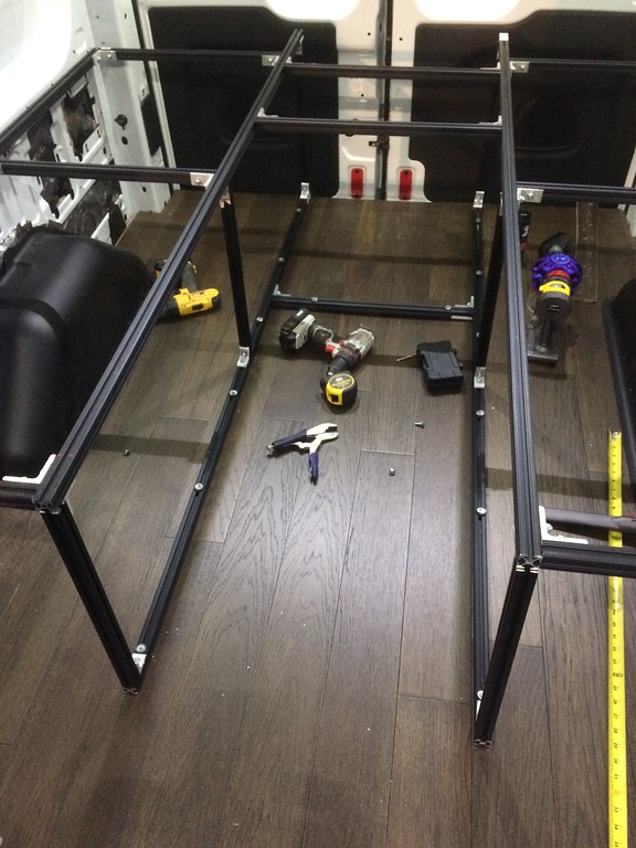

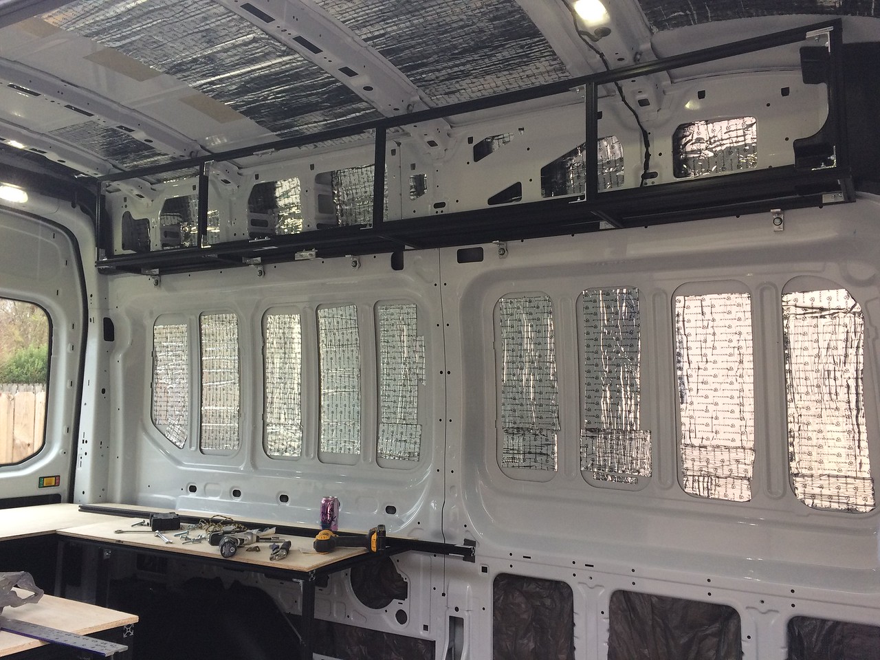

I built a van using 80/20 it was not the best idea because the hardware is ridiculously priced. In my last van build, I used uni-strut (painted with black bed liner)
Van build linky
80/20 Van Build
Van build linky
80/20 Van Build
Fair enough - it’s just the “system” aspect of it and the one stop shop aspect that caught my attention. That is PURELY because of how lazy and incompetent I am - someone with more ingenuity and initiative could pull stuff together for less.

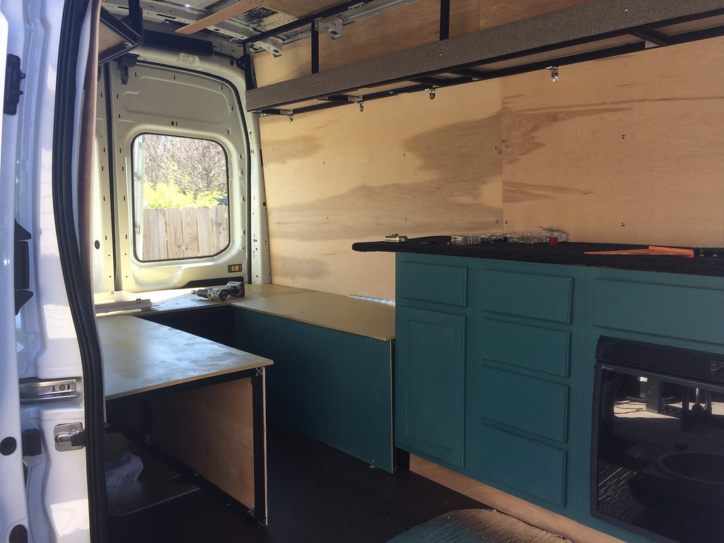

That was my thoughts, I am not a carpenter and I have no patience, so the 80/20 would be great. But, when it came time to close the fronts and make drawers, it was very difficult to tie into the rail without using the expensive hardware.

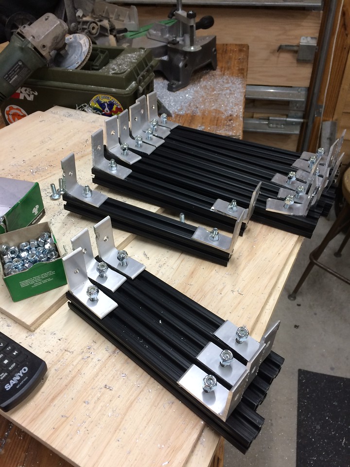

Also note how I simply cut aluminum angle and used 1/4" carriage bolts to build the structure.
When I read your post, after reading the first bit I thought just use coach bolts. Reading farther that’s exactly what you did. 👌🏼. Save money on expensive fittings. You just call them carriage bolts.
