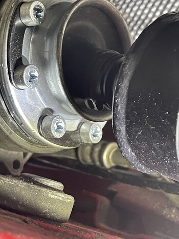

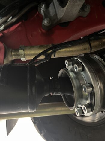

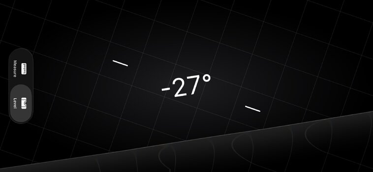

Here’s my kinda unscientific measurement via my iPhone leveling app. I also have 1.2° of slope to my garage floor.
18 pinion, 27 driveshaft. -1.2 for the driveway slope
