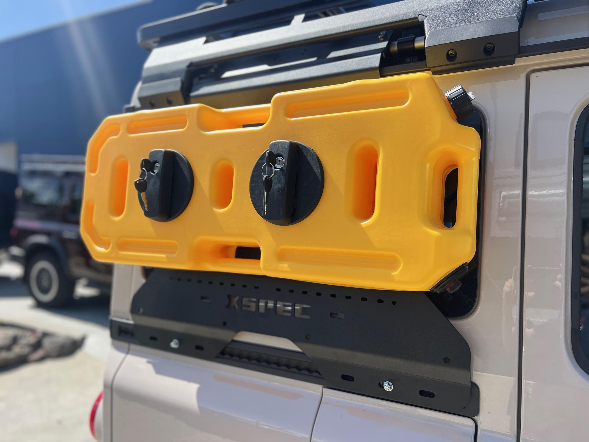

The yellow XSPEC 30 litre diesel tank is mounted on XSPEC Window Utility Frame. These tanks come with an integrated funnel/spout/pourer in the cap. When the tank is sealed, the funnel points inside the tank. If you are pouring out fuel manually, the funnel is reversed and it gives you a funnel to go into the car filler neck.
WORD OF CAUTION: when the funnel is inside the tank make sure the funnel is flat against the opening and not at any angle, even a slight one. I recently had a small diesel leak out of my tank. I stopped and found a small amount of diesel across the back of the car, when doping a walk around. I thought the cap may have come loose, it was tight. Off I went.
I kept a close eye on the tank and it was leaking again. I stopped. The cap was not loose and everything looked sealed, until I undid the cap. When I did that, I could see the funnel was not flat against the container opening, leaving a very small gap in the rubber seal – the source of the leak. It was not visible until I undid the cap.
I am now sourcing a cap without a funnel to avoid this problem. XHQ are helping. I will put the funnel cap in the car if I need it - I normally use the electric fuel pump. This way I can always ensure a good seal when putting on the cap.
LESSON: check the car when you stop to find these issues early.

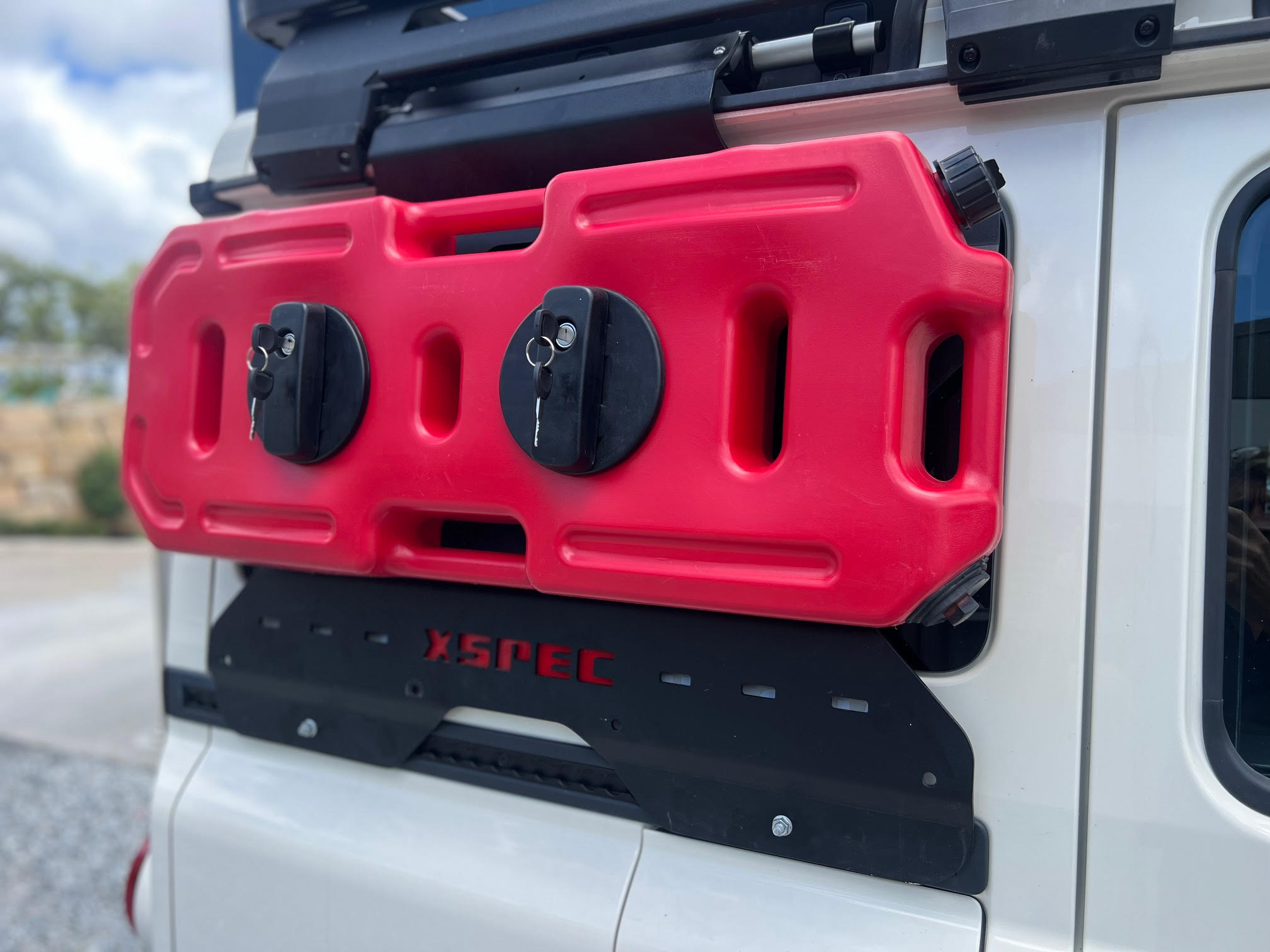

The red 20 litre XSPEC Petrol tank also has a reversible funnel.
Petrol model

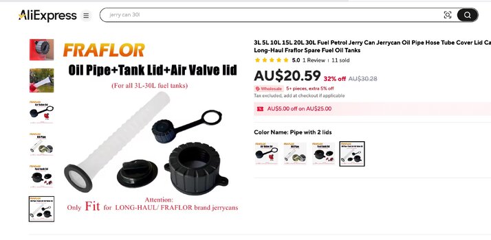

The manufacturer is 'Long-Haul' and I bought a second tank online which proved to be identical to the XHQ one when it arrived. I just had to pay a few bucks for the locksmith to match the locks from the second tank to the keys from the first tank.

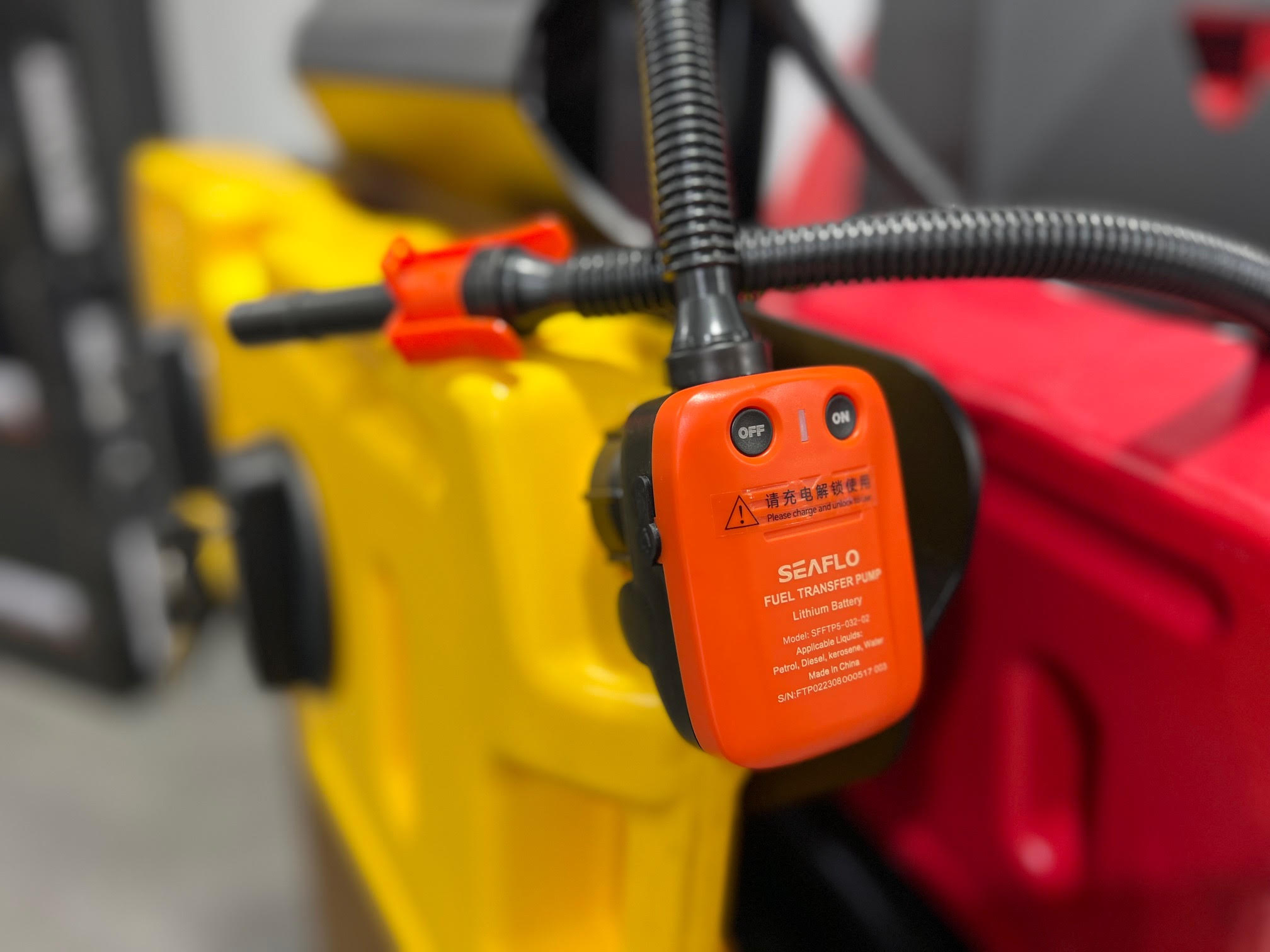

I have the SEAFLO here. It works really well and is stored in a dry bag (zero diesel odour in the car).

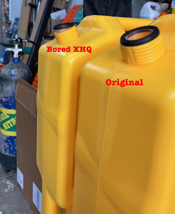

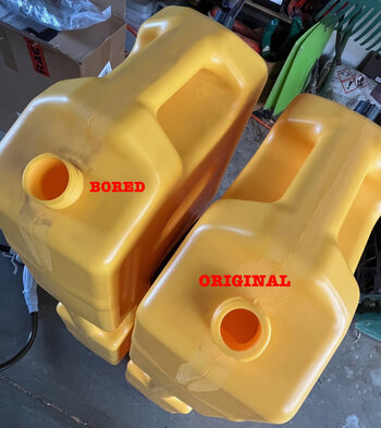

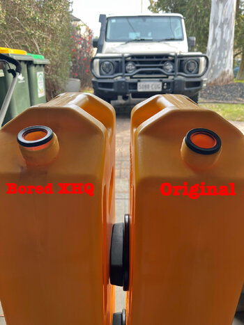

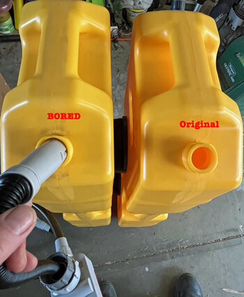

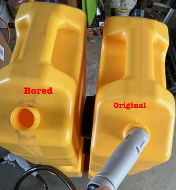

XHQ had to bore out the opening on the tank to allow the SEAFLO pump to be inserted. The default opening is too small for the pump to be inserted..
I haven't used the second tank that I bought online and have just compared the mouth opening. You are right, the one from XHQ has been bored out and I think that is probably the reason for the fuel leak. The funnel and seal don't sit flat by themselves in the bored out (XHQ) tank and the caps have to be carefully screwed on each time and checked that seal is good. In the original tank the funnel and seal naturally sit flat and tight against the tank mouth without the caps on(in fact to remove the funnel you need to pry it out with your fingers).
The electric pump pickup won't fit through the mouth of the tank I bought online so I will need to bore it out like XHQ have done if I want to use the electric pump. The 30L tank with 2 locks cost me $182 delivered to my door in Adelaide which is less than half the $399 + postage cost from XHQ. However, I did have to spend $20 getting the locks matched so that one key would open all 4 of the locking mounts rather than have 2 sets of keys. The inside bore of my XHQ tank has rifling/screw marks but I will probably just Dremel my other tank if I want to use the pump with it.
The electric pump I am using is; https://easyflo.com.au/battery-powered-pump-handle-power-switch-and-auto-off-sensor/
I have a friend using the seaflo pump but I prefer the Easyflo which is very similar but is sold by an Australian company in QLD. It is Korean made but spare parts, accessories and support are all readily available from the local Qld company. I haven't been able to find any local support for the Seaflo 12v pumps. My friend bought his Seaflo on Temu.

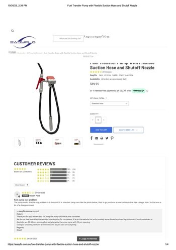

I already had an older Easyflo 12v pump(see attached pic) which is very similar to the XHQ Seaflo for use with fuel jerries and drums but I wanted a dedicated one for the car so got the new model Easyflo with the on/off power switch in the nozzle handle rather than on the jerry. The new model also has a proper industrial strength PVC fuel filler hose.

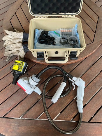

I copied Ronny Dahl's setup and store my pump in a $40 Bunnings Tactix tough case which is airtight and keeps the fuel fumes out of the car. Dry bag is a great idea...except I didn't think of it! It would pack better than the hard case.

I was handed the wrong tanks when XHQ did the install. Later I am at Cunnamulla wanting to get the fuel and the Seaflo pump would not go into the opening.
When I got back to XHQ they said there was a mix up, I was given the wrong tanks. I saw them bore the hole bigger.
Your observations about the larger opening helps explain the leak.

Looking at their website, they do mention minimum container opening required is 32mm, and that some containers sold in AU are only 29mm.

I ordered the wrong size Viton gasket, despite measuring it all. Trying again.
VITON GASKET
I now have the correct size Viton gasket, linked below. I am doing some testing to ensure there are no leaks. EDIT: no leaks the Viton gasket works.
The OEM cap has 3 parts. I have removed the spout and inserted the new Vition gasket. I now must ensure the tank does not leak when traveling, while the tank is full.
The new setup is already fitted to the empty tank and the modified cap feels like a good fit. The Viton gasket seems like a better fit than the flimsy OEM gasket on the spout. Thanks Tassieman
The correct gasket is the Viton GT100-VT, from here (AU source). It is 1 inch or 25mm:
Just did a short 13 minute test drive, targeting speed humps. :ROFLMAO: No leaks on the full tank.
There is enough flex and thickness in the Viton gasket to get a good seal. The gasket sits snugly into the cap. I do not expect any leaks, but time will tell.
On Wednesday the full tank will get a 3 hour high speed test drive up the Pacific Highway and back again 2 days later.
All good after a much longer drive.
I just inspected the Viton gasket on the empty tank. I looked at both sides, each side fits really well into the cap.
The thicker Viton gasket is much better than the flimsy seal on the OEM spout. The Viton looks better when you inspect it and it feels better when you tighten the cap.
Problem solved. I do not see any similar fuel problems arising, Spouts now stored in the car with the Seaflo fuel pump. So I can use the pump and have a manual back up.
