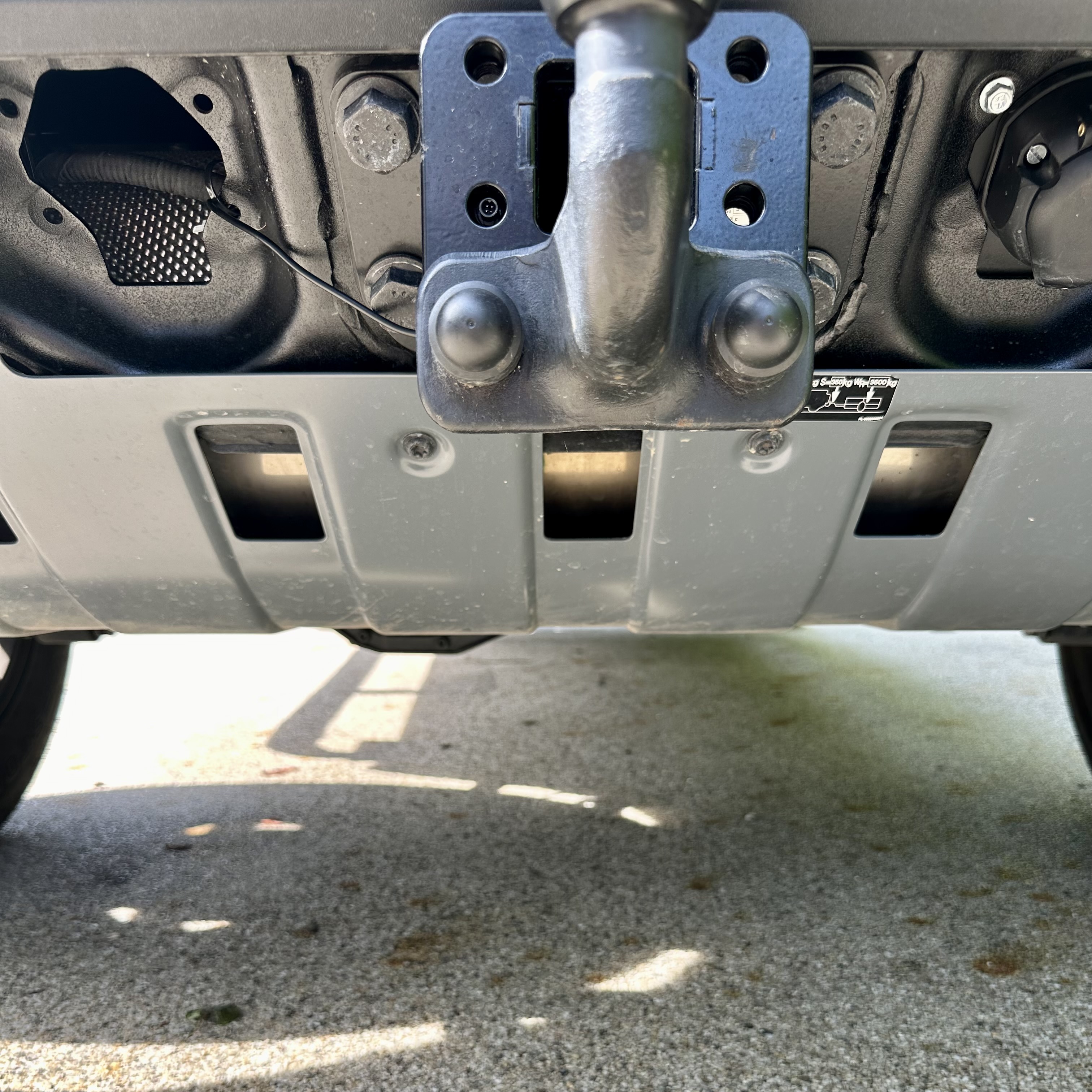

I then ran another cable through the unused nato socket space, using a handy hole in the towball assembly for connecting to the trailer camera.
Like so. Very satisfying.

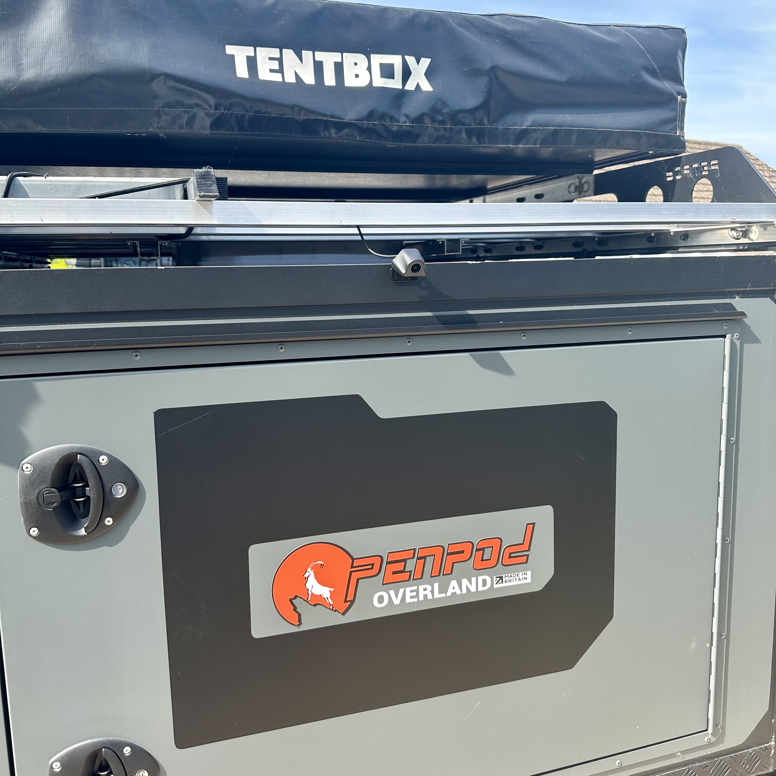

The second camera then lives on the back of the trailer like so, with the end running under the trailer to the towing hook as above.

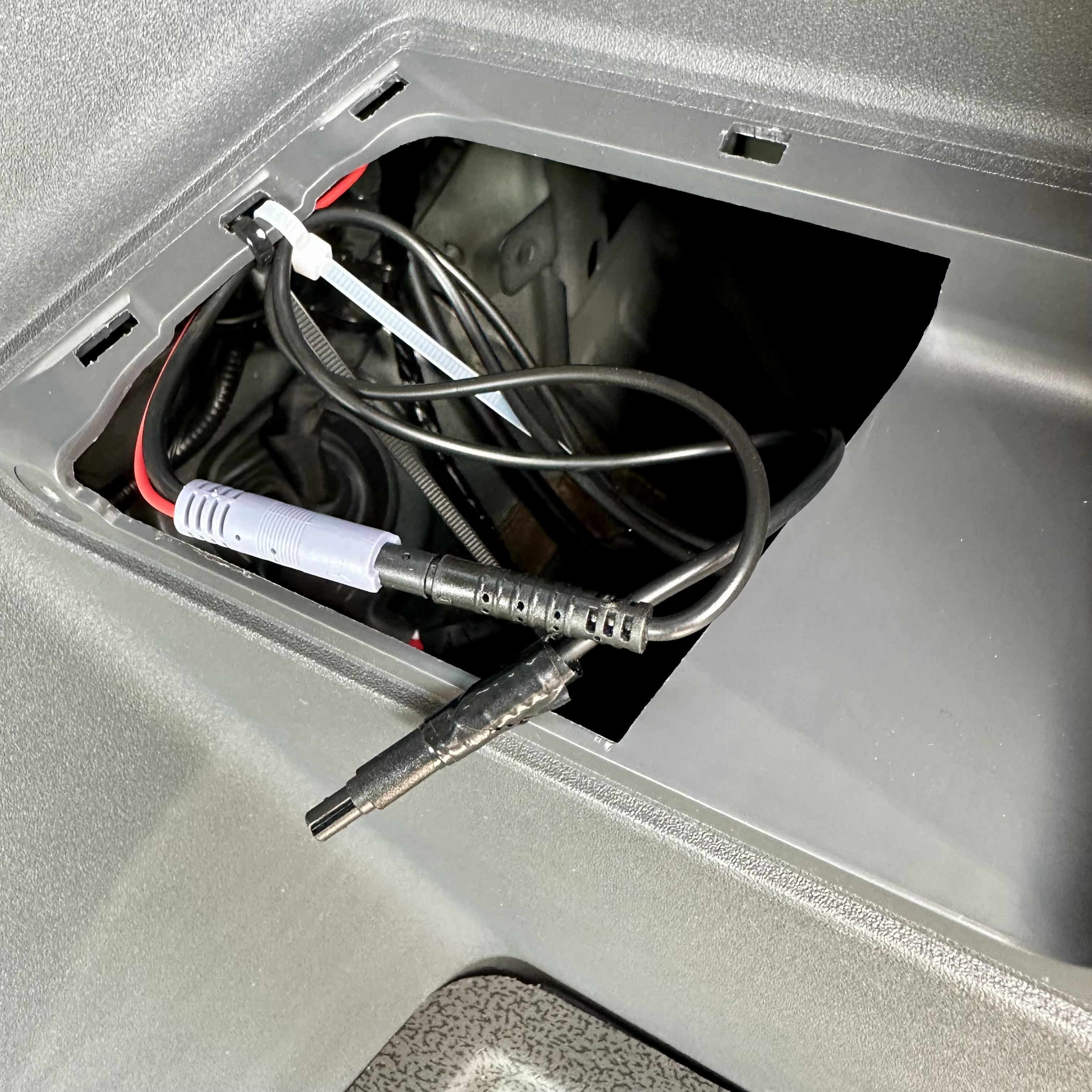

Both cables (the one for the normal camera and the one for the trailer camera) terminate in the handy pull-off-lidded box in the boot, and I cable tied to the inside of the box, allowing for an easy manual switch-over from one camera to the other when the trailer is hooked up.
Really pleased with this. Switching across is pretty quick and easy too. I might chop the ends off the cables (or more likely buy some sacrificial short ones) and add a switch / relay to make the changeover process less manual. It’s such a rare occurrence that I’ll probably leave it like this though.

Looks like a great set up. Just be mindful of the position where the wire is cable tied to the receiver hitch. This is the location for the tie down chains to hook to the vehicle. Will wear through the cable in no time.
