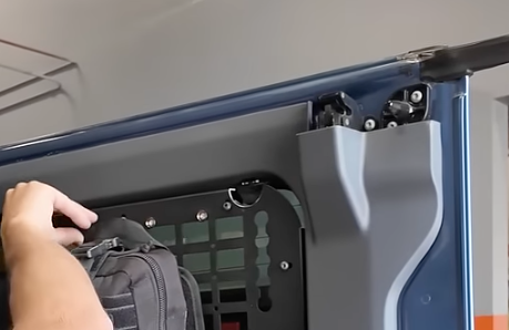

No, but many have performed smalll modifations to cut out about 2-3” across and about the same down. I am sure you could mount to molle, but the cut is very easy and minimal. Then a bit of touch up paint…..

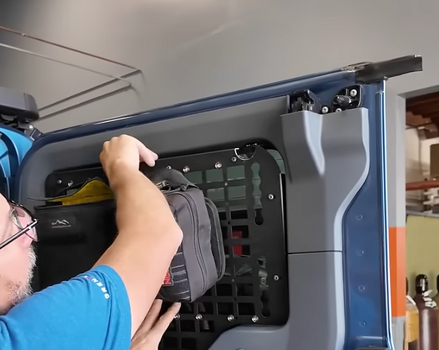

Cutting the molle panel is NOT absolutely necessary. However, it is cleaner! Here is an image of a cut / modified RRE rear panel being installed (from Agile you tube video
View: https://www.youtube.com/shorts/NzDipON8Csk

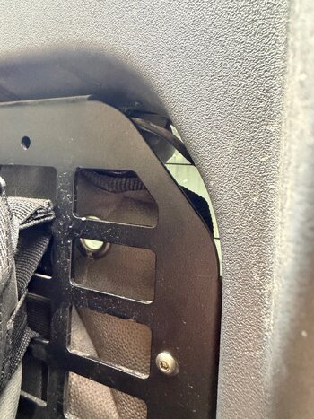

). I purchased another brand of Molle panels prior to RRE releasing theirs. I opted NOT to cut the corner out, as at the time I was not convinced of the Wolfbox camera location nor having the molle panels in general. So, instead I have one less connection point screwed in - as you can see in my photo. The panel actually lightly presses against the Wolfbox camera housing and helps to hold it in place. Since I can lo longer see out the window, I also placed thermal regulating window shades to help moderate the hot and cold days. The shades are positioned right against the glass with the molle panel installed over it. This makes molle panel install a little more difficult - but really pays off since I sleep inside the Grenadier.

Cleaner, yes, especially with OCD people… necessary, no, but it helps. The truth as stated above. Once you have the camera installed, you are nearly never reliant on your rear window, therefore any rear window additions are more for preference and function, of the user.
