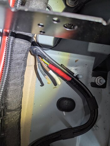

Hi @pedrogb
Are you referring to the 40amp spare/compressor circuit in an MY23?
I'm playing with that circuit now.
This circuit is fused at FI13 in the interior electrical centre behind the starter battery.
There are three wires:
Black. Earth.
Brown. +12v live to battery.
Yellow. +12v ignition switched.
I'm using the yellow wire to operate the NATO socket contactor so the NATO socket is live whenever the ignition is on.
When I test pull fuse FI13 the brown and yellow wires both lose power so the fuse is protecting the live and ignition switched circuits. However only the brown wire looks to be rated at 40amps (based on the wire sizes). Because you already have a switch in your compressor cable I would connect the red wire from your compressor to the brown wire and connect your black wire to the black wire, or direct to the body earth point next to the 40amp connection. That replicates how this compressor would normally be hard wired. If there is an inline fuse on your cable then keep it and connect before the fuse holder.
I know you only want it powered when the ignition is on but the yellow ignition switched wire does not look suitable to power your compressor which can draw 32amps. You can use the switch on your compressor to turn it on and off. You should run the engine whenever you use the compressor for more than a few minutes so you don't flatten the battery.

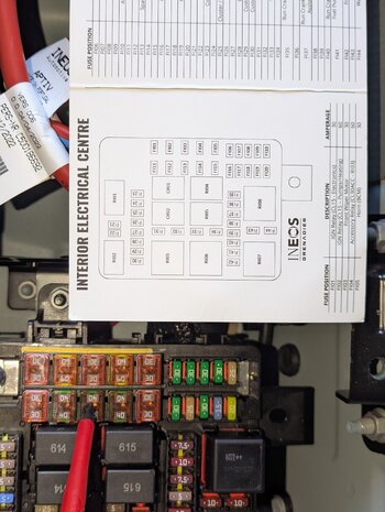

Check your fuse card for the interior electrical centre. This is the card for my MY23 Aus spec. See FI13.
The wires are on the floor behind the auxiliary battery position. There is a pic back at post 2 of this thread.
